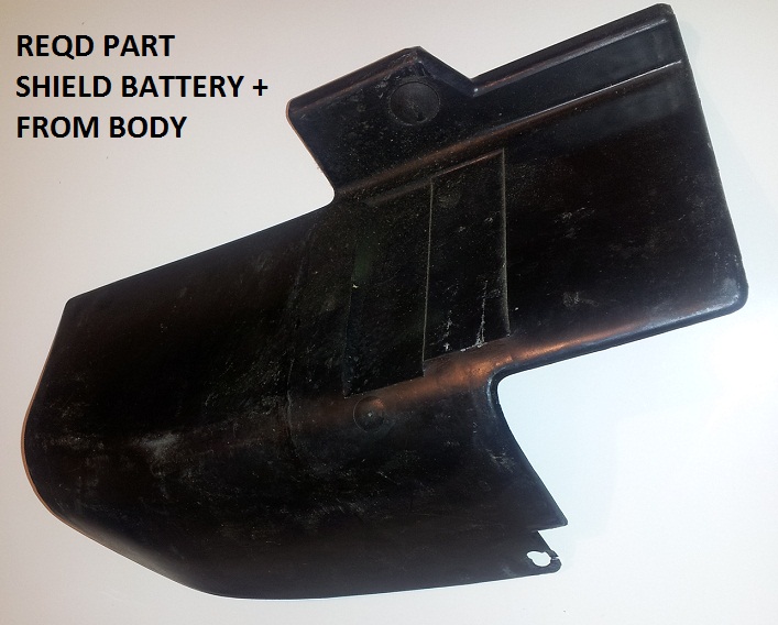

    Battery cable, mounting post in engine compartment, trunk battery tray-cover-fenderwell shield.

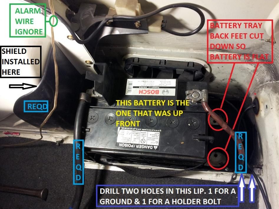

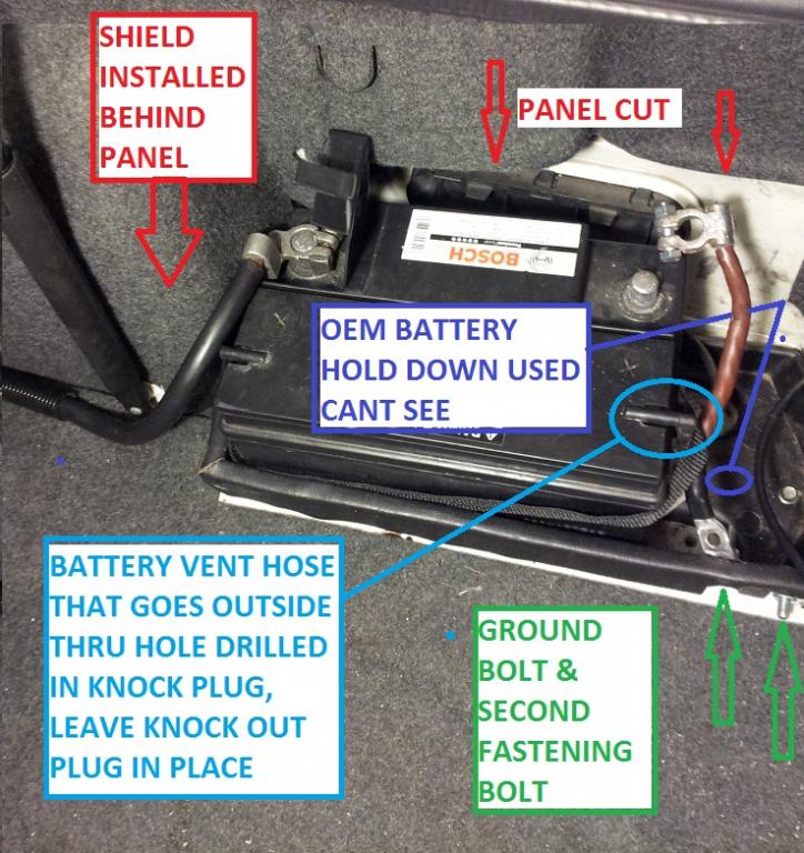

    >Drill a hole in the fenderwell drain plug for the battery vent hose.

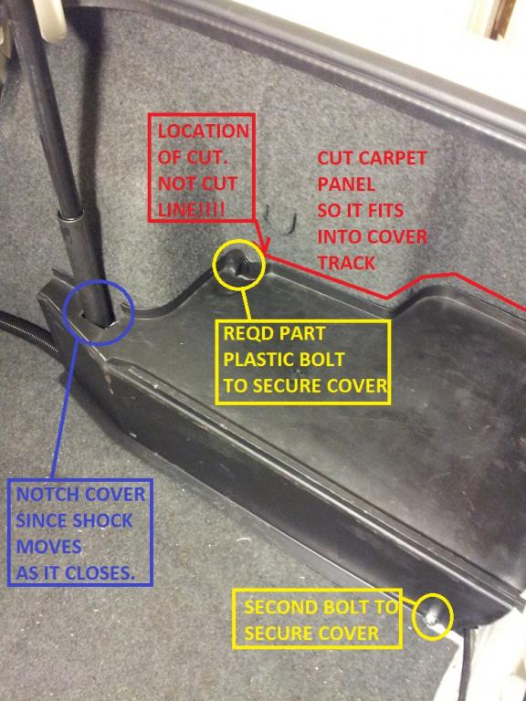

    >The battery tray needs to have the back feet cutdown so it fits flat. Added a couple of screws to secure it.
    >I drilled a hole in the inside lip of the battery surround lip for the ground. Clean the paint and nut and bolt then the cable and another nut.
    >Mark and cut the side carpet so the battery cover tucks underneath.
    >I added a second nut and bolt to secure the bottom back of the battery tray and used a plastic nut for the top securing point.
    >Notch the battery cover for the trunk lid shock to clear.

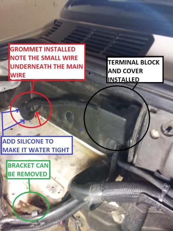

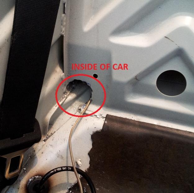

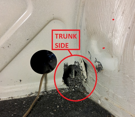

    >Mark the first metal wall into the cabin and use a drill with a small bit and drill lots of holes [poor mans nibbler]. File the edges.
    >Cut/split vacuum line down the middle. Add silicone inside the line the wrap the newly cut opening. Do the same thing for the bulkhead behind the back set.

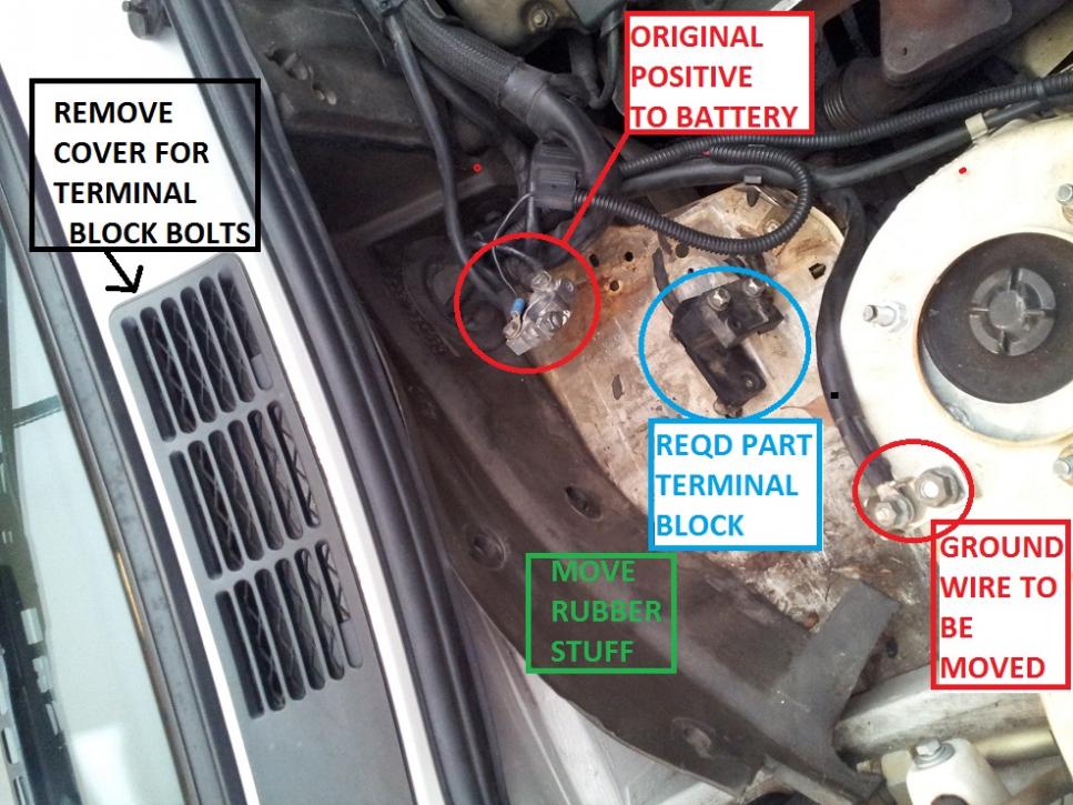

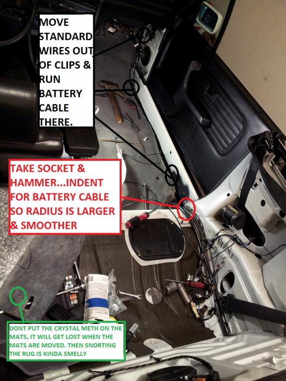

    >Remove the back seat, front pass seat, back side panel, rocker panel moulding, front speaker cover, glove box.
    >Pull the carpet away from the rocker panel. Remove the wires from the channel in the clips, thats where the battery cable goes.
    >Where the back seat stills on the metal panel area use a large socket laided lengthwise to bang a largere radius for the battery cable to run.

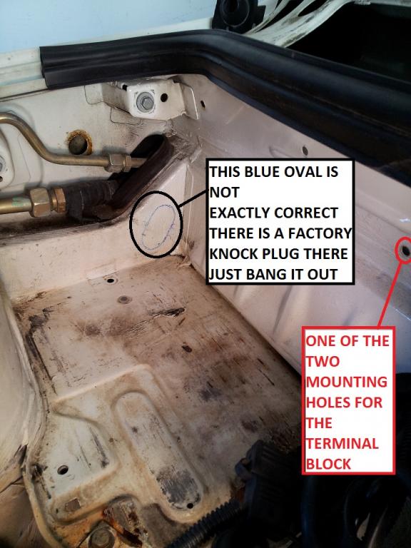

    >From the engine compartment, underneath the ac lines, on the triangle shape part is a metal plug to knock out for the battery cable grommet.
    >Remove the passengers side black plastic cowl [like where the wipers are]cover then mount the battery cable mounting post and hold the nuts tight in the cowl, put the cover back on.
    >Run the wires up thru the hole and add the grommet.
    attach the battery cables onto the post assemble.
    >I relocated the negative down lower on the body to clear out the clutter around the old battery box area.

    heres some pics as attachments
    im kinda dumb and havent figured out to just show the pic directly

      more pics

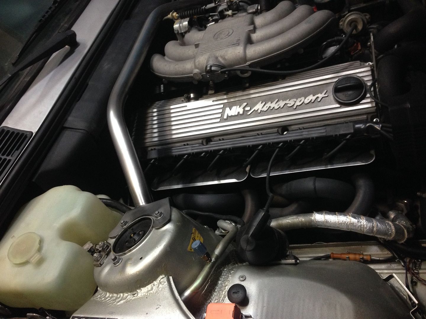

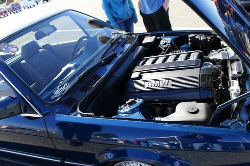

          Good job. Nice write up. I did mine only to clean up the bay.
          Before
          After
              Before
              [ATTACH]66124[/ATTACH]
              After
              [ATTACH]66125[/ATTACH]
              sweet ride.
              love to have air suspension

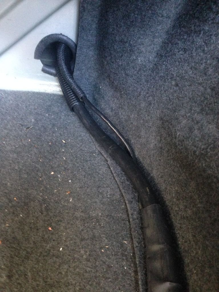

                      This thread was really helpful but I didn't want to drill any holes, so this is how I did it
                      First familiarize yourself with the front and rear attachment points for the battery cable and make sure you have all the parts you need. These two pics nail it down.
                      Then, start from the back, there's a small hole at the bottom right corner of the first bulk head. Then fish it down through the body side panel and pull it through where pictured below.
                      But even if you do it this way, the cable will be too short to get to the stock distribution block mounting location at the front of the car. Most people add 6" - 12" of cable to the front or rear end of the cable. But then you lose the stock attachments. And especially if you add it to the back, the splice is in a location that's constantly being jostled. My advice is to basically cut the stock cable in half so that the splice is somewhere under the front door sill, where the cable is secure, and the splice is hidden.
                      Lastly, I used a longer oem negative cable from an older 7 series and attached to the stud on the back body panel. You can kinda make it out at the bottom of the pic above.
                      One more bit of advice, if you use the plastic battery tray from a coupe/sedan, the battery will tilt toward the front of the car. I'm in the process of modifying the metal tray that the vibration dampener was attached to. It's sits nice and flush and is secured to the car by four bolts. You just gotta figure out how you want to secure the battery to the tray. I'm going to use oem hold-downs, but it's gonna take some welding.
                      And then when you're done with all that, you can put an iX washer bottle where the battery was and show off your valve cover and headers ;)
