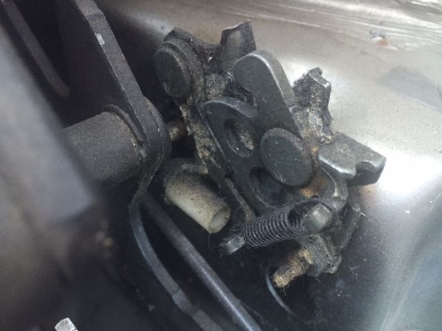

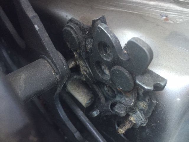

      Ok, here are some pics.
      This is the latch in the locked position, rear of car is to the right, this is the driver's side:
      Press at the point of the arrow in the direction of the arrow:
      Unlocked:
      View more from the angle you will have:
      I couldn't get the little lever and spring to show up in the photo but you will be able to see it.
      Good luck,
