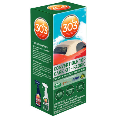

            I used these 2 products on my e30 convertible a couple years ago ( since sold ). I was extremely impressed. The top looked better than it ever had, and water beaded up and rolled off of it like it was waxed.
            I have detailed cars as a hobby for years and worked in a professional detail shop as well. Few products live up to the hype, I think this is one of them.
            303 Fabric Convertible Top Kit - Keep your convertible in tip top shape with 303 Fabric Convertible Top Kit! In the beginning, all cars were convertibles. Not until 1914, when the Dodge Brothers come out with the first closed top car, did a car with ...
