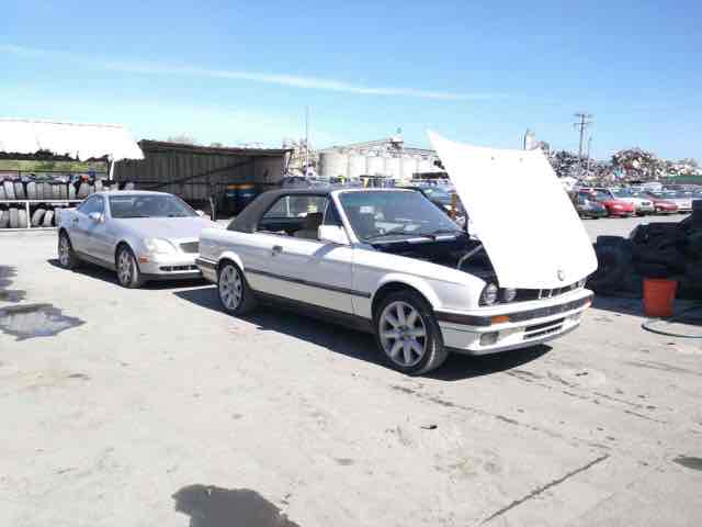

                        Months have gone by and I've been busy but here's an update: as I was contemplating on my engine swap options, I encountered a junkyard find that I could not resist. 91 325 vert with a hard top. It was donated to cars for kids because it became a California gross polluter.

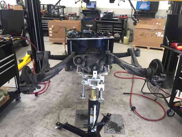

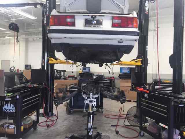

                        The paint on the car was in pretty rough shape but nothing some elbow grease couldn't fix. So I spent 10hrs working at it. 1) heavy duty abrasive clay. 2) 2 stage cut 3) machine polish 4) seal with wax.
                        If anyone's interested in pictures and products used for the detail feel free to request.

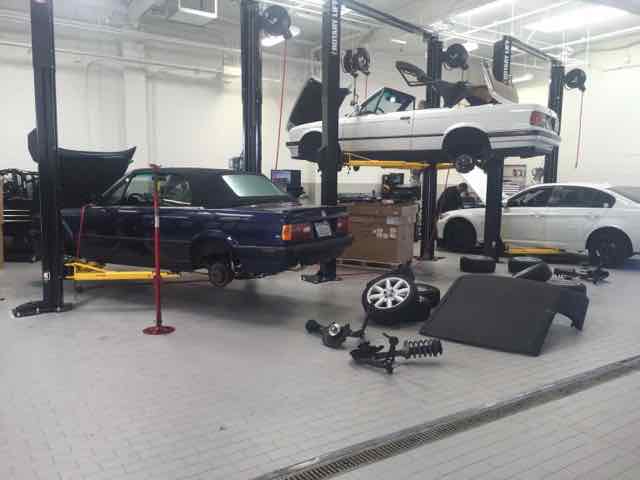

                        The car is automatic with a 4.10 diff. I picked up a getrag 260 5 speed trans and willing be performing a manual conversion in the near future.
                        After picking up this car, I since swapped my coilovers and front suspension from the 318 over. I also completely overhauled the rear suspension with condor 12mm riser subframe bushings, oem endlinks, and trailing arm bushings. Rear diff will get replaced with a 3.73 lsd (or similar) at a later date.

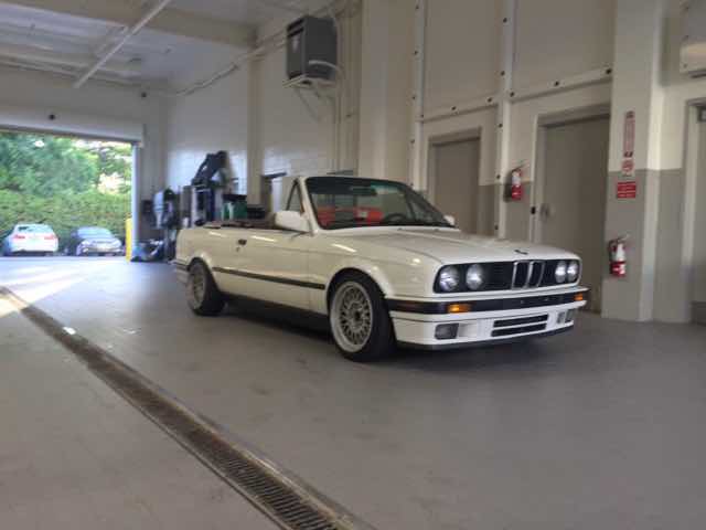

                            Nice to see another vert being saved, how is the chassis/suspension handling the heavier wheels? Stock 14" style 5's are about 14lbs a corner and I had e34 style 5's on my e28 and at 19lbs each corner, the suspension never liked them.
                            +5lbs of unsprung weight makes a huge difference, but I haven't tried it on a chassis that has this much flex...
                            • ricclee
                              • Mar 2016
                              • 59
                              Honestly, I'm pretty impressed with my setup. As for if its recommended for track or aggressive driving? -I wouldn't really be able to say since I'm riding pretty low and it's my daily commuter.
