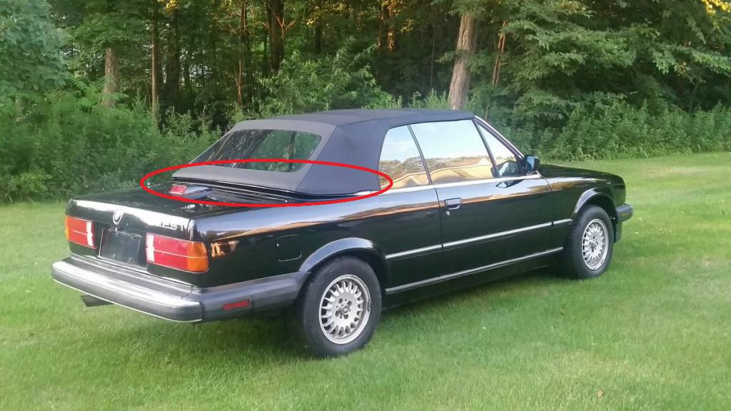

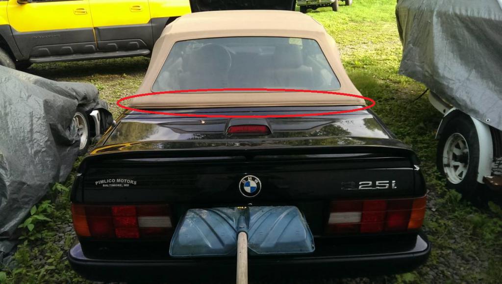

    First time poster so hello. I am looking to buy an E30 to go along with my 1987 E24 M6. I like the lines of the convertible and have looked at several.
    In looking at them I found one with a new, owner installed top that has a much greater gap between the rear bottom part of the top where it seals against the deck/trunk than another that I have looked at that appears to be the stock top. See pictures.
    Question: Is this an install issue or is this gap adjustable?

    That 1st pic made me do a double take since I've got the same car for sale (but w minty basket weaves) :)
    If the gap is uniform you can lower the entire top by removing a shim or 2 under the hinge. As far as the uneven gap I'm still working on that one. The top hinge arm has an adjustment bolt (look inside) which in theory would allow you to raise or lower the corners but that bottom "beam" is incredibly rigid so I'm not sure the adjustment will flex that and change your gap rather than just change the tension in the canvas from the C pillar to the rear vinyl window.

        For what I understand it's the top fabic part that has been installed like that . If the seal is against the frame then you cant do much to close the gap you see.
        I had two e30's verts
        One has OEM BMW too and the other appears to be cheap replacement. OEM sits flush almost in rear and the aftermarket one has gap you guys are looking at. I tried to adjust and figure out what could be causing this but could be bad install, or the way the top was made... sorry for Grammer but my phone is really laggly and hard to type at the moment..
            Correct-That's the way I see it too.
            Mine has a gap as well and the seal on the frame seals perfectly tight against the deck, so I don't know how removing shims would reduce that gap.
            I would say, top installation error, or top material shrinkage due to age.
