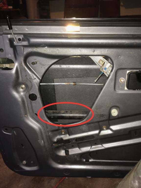

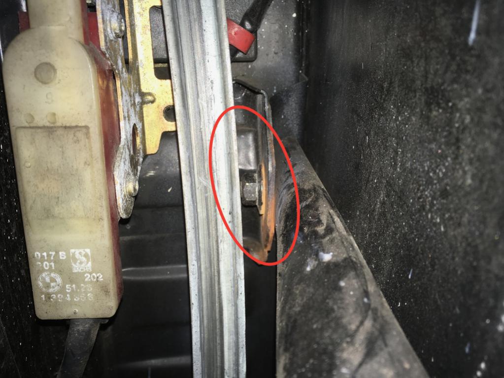

    My vert had had a terrible knock/rattle coming from the driver door whenever I went over bumps. It was a good gauge of how severe a bump was, but not really enjoyable I thought I would never fix it, until today when I took a look in my door and found that the (what I assume to be) vert specific door reinforcement bar was loose. There wasn't any play, but the 13mm nut on the left side required a fair bit of tightening. Easy fix, and I won't lose any more sleep over a rattly door! :yawn:

            Anyway no joy with the 13mm nut on the side impact bar. Assuming you're talking about the nut towards the rear of the door near the window track. It was super tight in my case and not the cause of my rattle. I'll chase it down someday.. all I know is there's no noise when you shut the door with the window up. Maybe the window rail lining pieces are worn out. The weatherstrip is all new, and anyway the window tucks below that weatherstripping when down so that's not really a factor.
