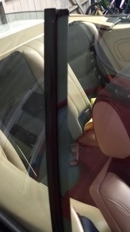

    I recently replaced some of the rotted rear window gaskets in my 'vert. However, when I went to move the window up, the vertical piece that separates the front and rear windows somehow got caught in the new gaskets, popped off, and fell inside the body panel (under the window mechanism).
    I've given up trying to fish it out, and can't figure out any way to access the area under rear window.

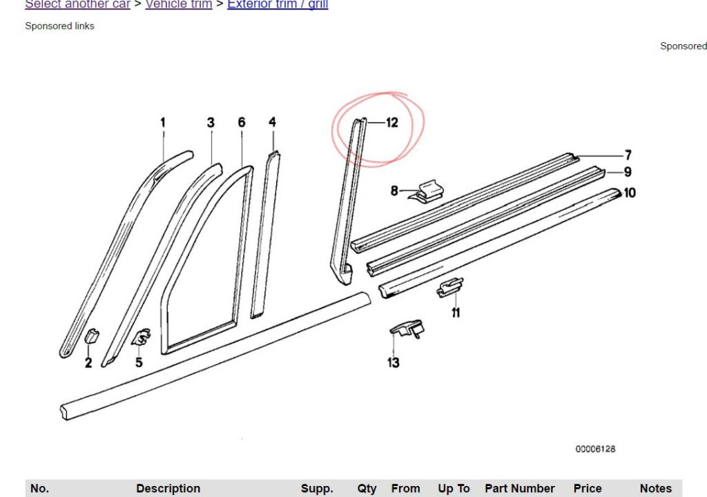

    Checking out realoem.com, I found this part 51361922167-BOE (part #12 in the picture). But after getting it, it's a flexible rubber piece with a hook shape at one end, and not the hard plastic divider that's i'm looking for.
    anybody know what the right part number is? I've attached a picture of what I'm looking for.

        yep, unfortunately, the (metal and plastic) piece snapped off of the window.
        OK, just realized that this piece comes with the window. Guess I'll be replacing the whole assembly...

                  It's the hard piece that attaches to the rear glass. His fell down in the hole of no return.

                    Indeed, I just removed the window and dug the hard piece out of the hole of no return (Ha!).
                    After reattaching it, I realized that the rubber piece I ordered (#12) fits INTO the hard piece on the rear quarter window of the convertible. So, the parts diagram is correct.
