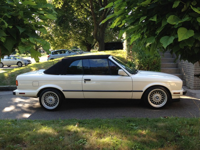

    Just installed the ST speedtech /kyb kit from ecs Ride quality is like stock, also corners nicely.
    Got a bit of front rake, will wait to see how it settles before removing spring pads out of the rear.
