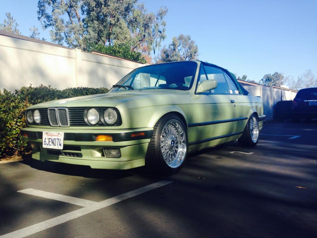

    • E30Jigzaw
      • 1197
      #497
      Originally posted by fporro
      you're welcome,
      btw, color, never seen it on a e30, what's the name ?
      bumper swapped too, nice :)
      16x8" wide rims with offset between et12 to et15 should work with those tires.
      Thanks :) and its RECETA Green off the e21 ... i wanted to do something different

                Yes the fenders are rolled ..
                New wheel set up 17" rc090
