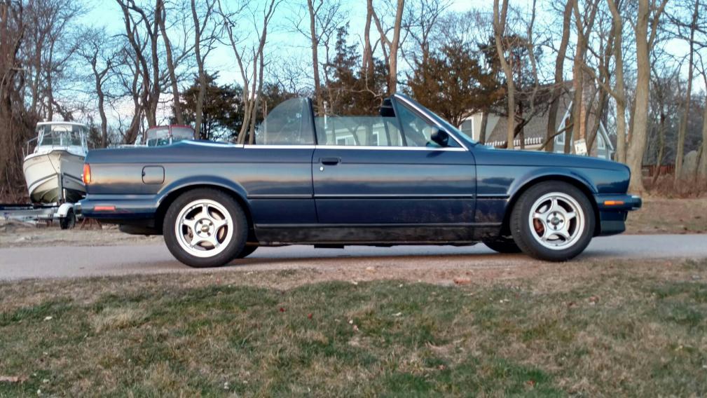

Here's mine with the Bavauto e30 vert springs and Bilstein shocks. Wheel tire combo is 15x8 et20 with 205/55/15. Ride is a little rougher then what I've read about on line. But overall I am happy with it.

Jason yours looks decent. Late model's look nice but an early car with right wheels and color is just as equal.
Thanks! I tried my best to keep this car looking stockish but wouldn't mind getting rid of the third brake light and adding a 3 piece Kamei spoiler like I had on my black car, plus a Kamei front lip for the late model. You probably already know my thoughts about how earlies are better looking then lates.
