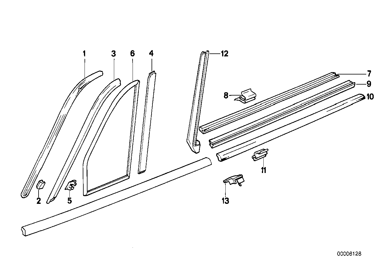

    Real OEM lists these as Gasket Left & Right (part #12 in this diagram)
    Warning – they’re not cheap!
