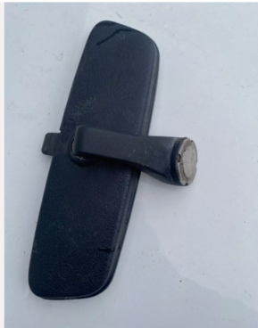

              MoreMayhem , Thanks for your post in 2021! I need to re-install the rearview mirror on my convertible. It currently looks like this:
              I think I just need these two items, but am I missing anything else? And how do I actually install it to the windshield? Just epoxy? I don't really understand how the base plate and cover connect to the mirror. Thanks!
              51161954117 - BMW Cover, base plate f interior mirror. Dippable | BMW of Monterey, Seaside CA
              51318145530 - BMW Base plate, rear view mirror, interior | BMW of Monterey, Seaside CA
              • MoreMayhem
                • Feb 2012
                • 650
                Your local auto parts store should have a little mirror attachment kit with everything you’ll need. If I remember correctly the round cover is a trim piece to hide the gap between the base plate and the mirror. Would work fine without it, but you’d see a little gap between the mirror arm and the windshield
