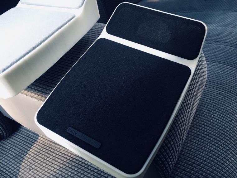

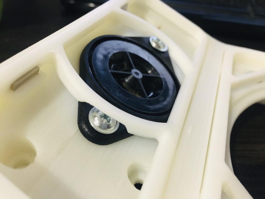

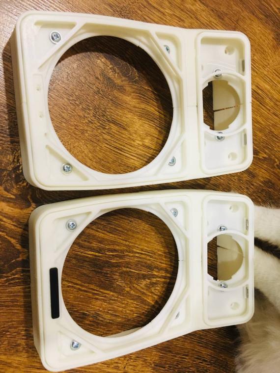

    BMW Sound System rear box
    OEM-numbers: 65 13 1 381 473, 65 13 1 381 474, 65 13 1 381 475, 65 13 1 381 476, 65 13 1 381 477, 65 13 1 381 478, 65 13 1 381 726
    Click image for larger version  Name:	photo_2022-08-20_16-29-16.jpg Views:	0 Size:	64.2 KB ID:	10070852
    Download link: https://cults3d.com/en/3d-model/gadg...5-13-1-381-473
    Description:
    Original components (speaker and tweeter) can be mounted!
    I recommend to skin covers with acoustic-transparent textile or any other acoustic textile.
    There's holes for magnets - this is how covers mean to be fastened to the speaker box. Neodymium magnets i used: L10W5H2.
    Still needs some sand and paint works, but even in "white" color and grey covers looks pretty good on the rear shelf that is also grey.

      Looks like a good solution, especially for those who want a stock look and different components without chopping up original parts. Good work OP!
      If only someone made a non stock rear speaker mount for a touring...

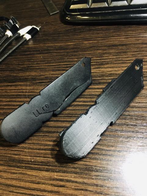

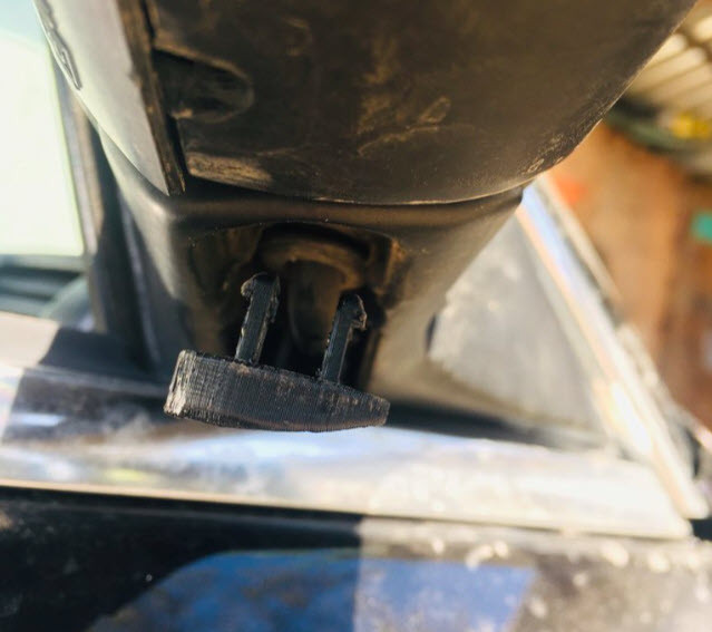

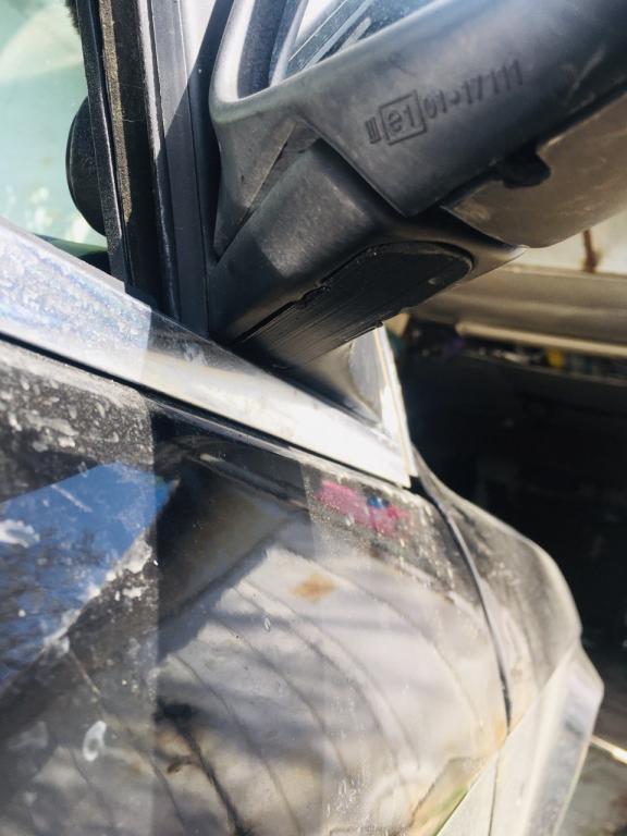

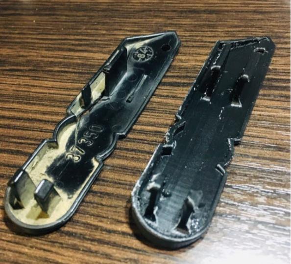

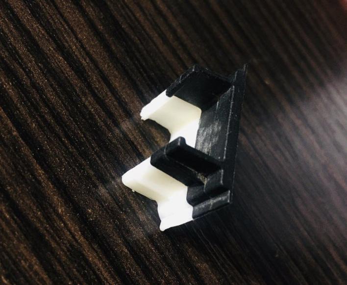

        Mirror wiring bottom cover
        OEM-numbers: 51 16 1 937 441, 51 16 1 937 442
        Click image for larger version  Name:	photo_2022-10-08_15-12-05.jpg Views:	0 Size:	63.7 KB ID:	10070903
        Download link: https://www.thingiverse.com/thing:5378122
        Description:
        Perfectly fits on its place. Cover latches made a bit reinforced so it could live long, i found many original covers with this latches broken.

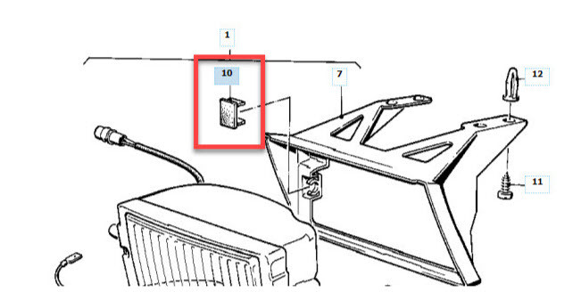

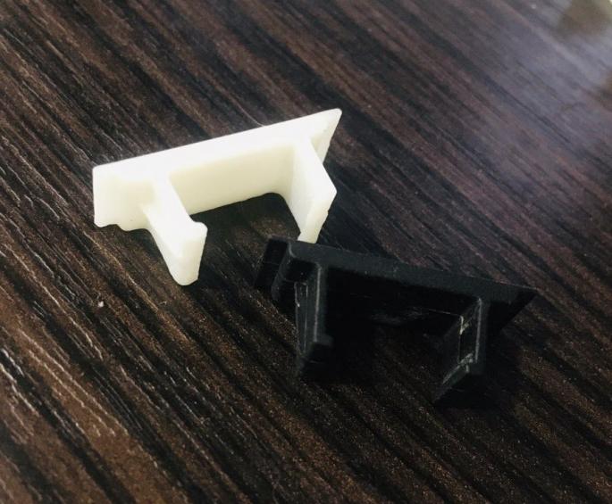

          Fog lamp bracing cover [for early model]
          OEM-number: 63 17 1 373 577
          Click image for larger version  Name:	photo_2022-07-22_14-36-48.jpg Views:	0 Size:	55.7 KB ID:	10070912
          Download link: https://www.thingiverse.com/thing:5438938
          Description:
          Reproduced with the dimensions of original part.

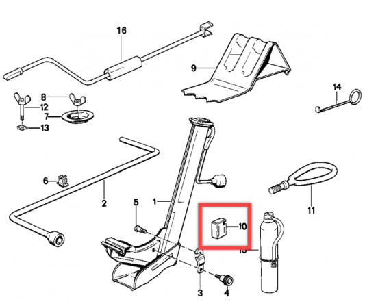

              Trunk jack mount cap
              OEM-number: 51 71 1 916 269
              Click image for larger version  Name:	2023-01-10_22-50-32.png Views:	0 Size:	144.9 KB ID:	10080650
              Download link: https://www.thingiverse.com/thing:5749651
              Description:
              I see some E30 owners don't even know about whis part, so here it comes)
              Reproduced with the dimensions of original part. Perfectly fits on its original place.

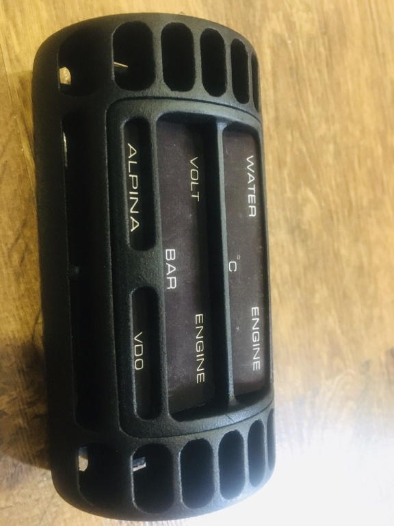

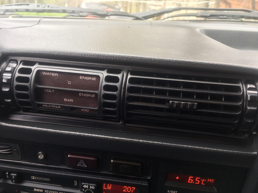

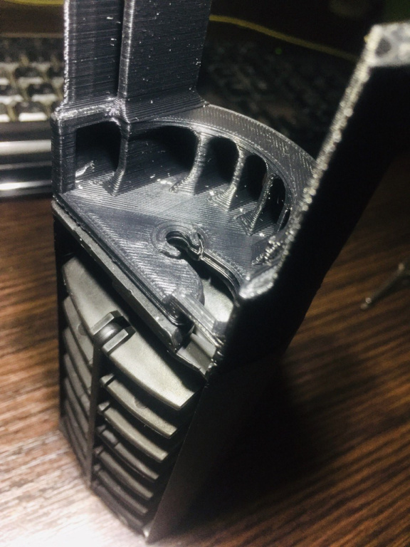

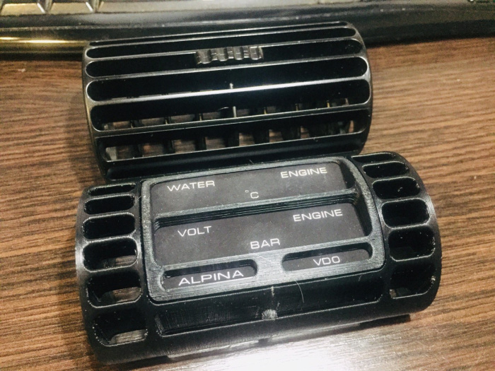

                        *WIP*
                        Some interesting things in progress!

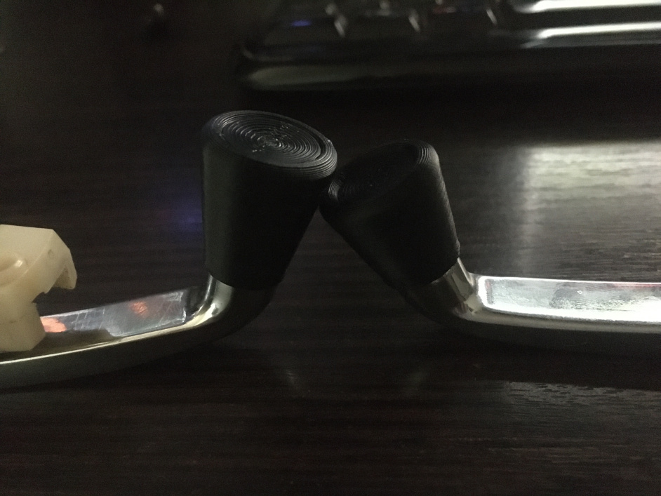

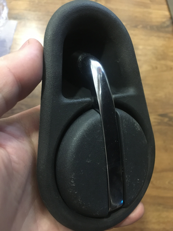

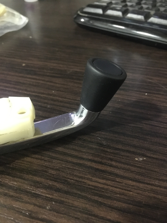

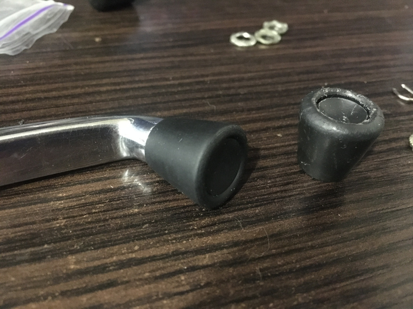

                            Sun roof handle knob (also for E28, E21)
                            OEM-numbers: 54 12 1 859 594
                            Download link: https://cults3d.com/en/3d-model/tool...4-12-1-859-594
                            Description:
                            The old knob has a wear of 30+ years. It may drop down sometimes, or break, or lost.
                            There are 2 handles versions exists. 6mm rod and 8mm rod.​ I have modelled knob for both versions.
