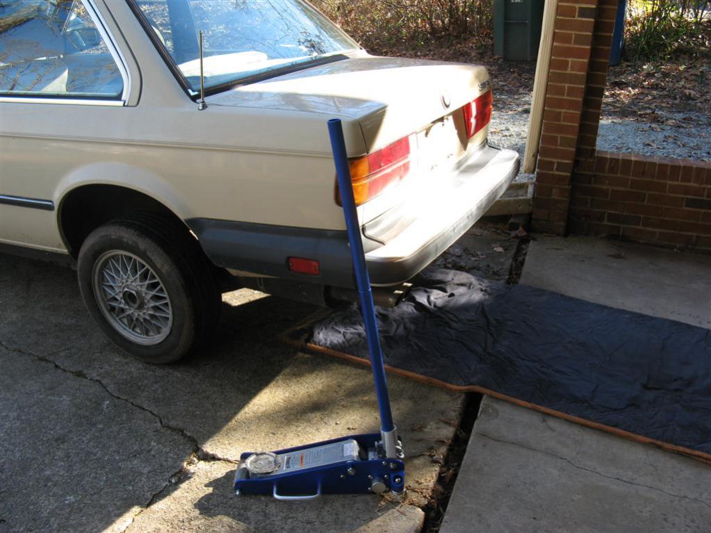

    -jack/jackstands for extra clearance. Ramps will also suffice.

    1) get the rear end up.

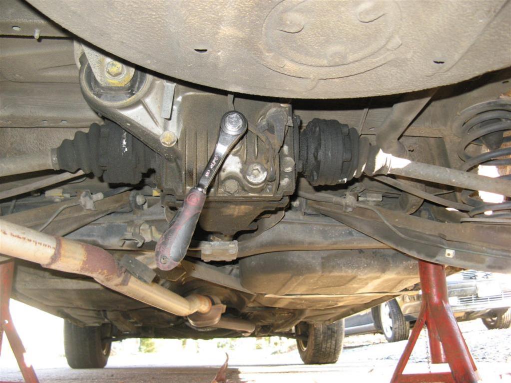

    2) Get your hex key and loosen the top drain plug.

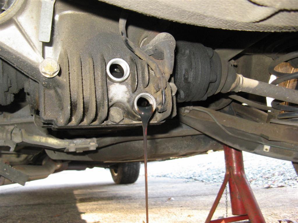

    3) After removing the top drain plug, move on to the bottom.
    4) Wait a while until you're satisfied that ALL of the old fluid has been drained out. I think it took mine about 10-15 minutes.

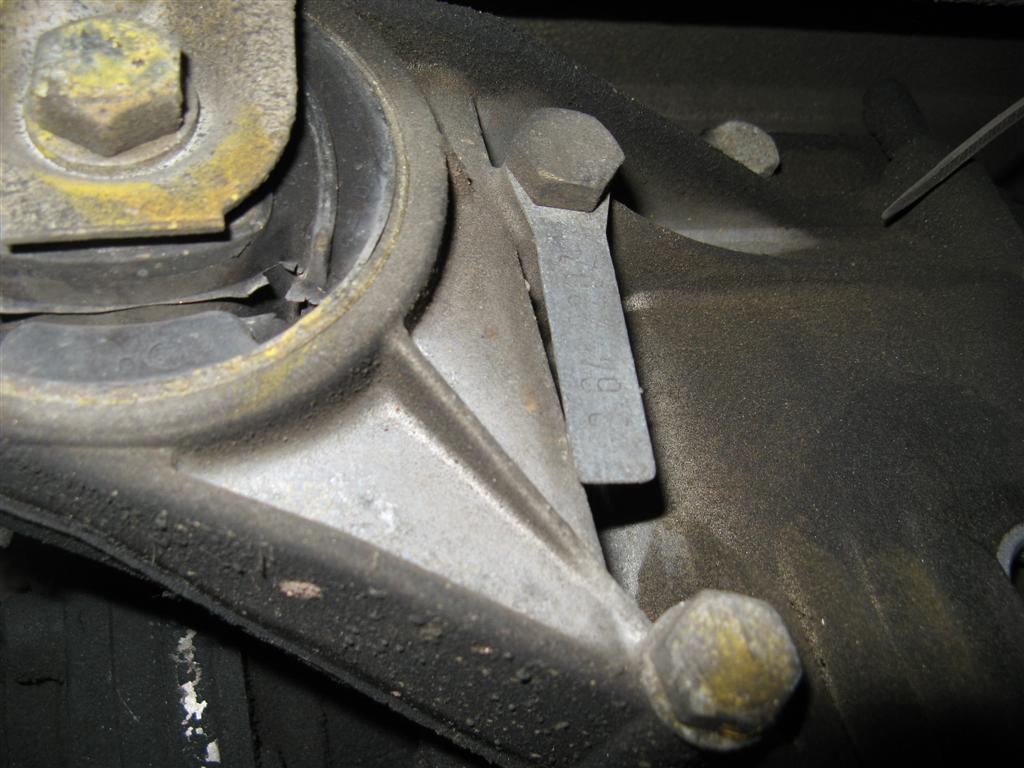

    5) Now is a good time to inspect your diff bushing and see what rear end your car has. This is the marker.
    6) When the fluid is all out, put the lower plug back in. You can torque it now, or wait until you're all done. the torque spec is 41 ft/lbs.

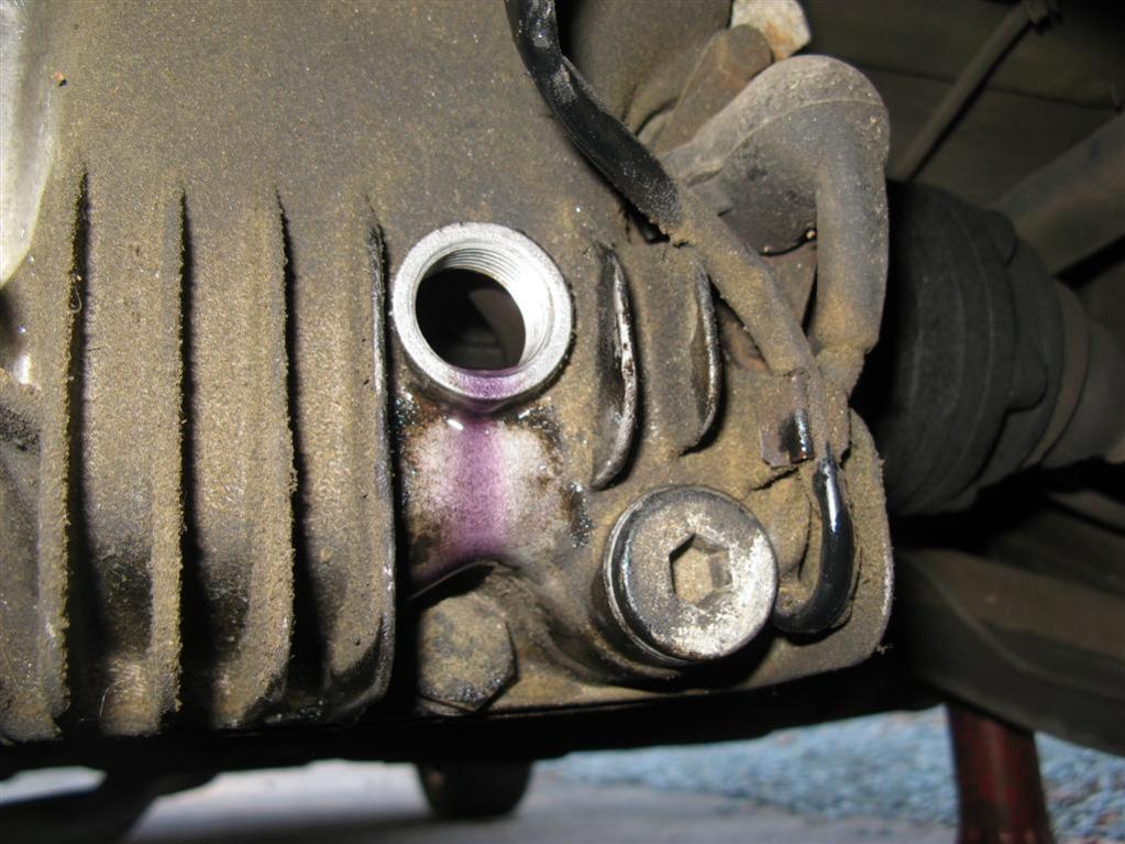

    7) Fill the diff with fluid. You can use a siphon pump, which didn't work too well for me, or you can do it straight from the bottle with a small hose to go into the hole. The second method was a LOT faster and easier. When the diff is full, you'll see the fluid start to drain out. I recommend you pull your gear oil bottle away from the diff, wipe the top drain clean and see if it continues to come out slowly(you might need a flash light). If it doesn't, it was just spillage from putting the oil into the diff. Keep filling. It'll look like this:
    8) TORQUE DRAIN PLUGS. 41 ft/lbs. Don't forget!

    my diff shat itself and not its all full of greasy oily muck :'( Doesn't look like its leaking anymore though?

      Oh, and in case you didn't notice OP, your diff is leaking.
