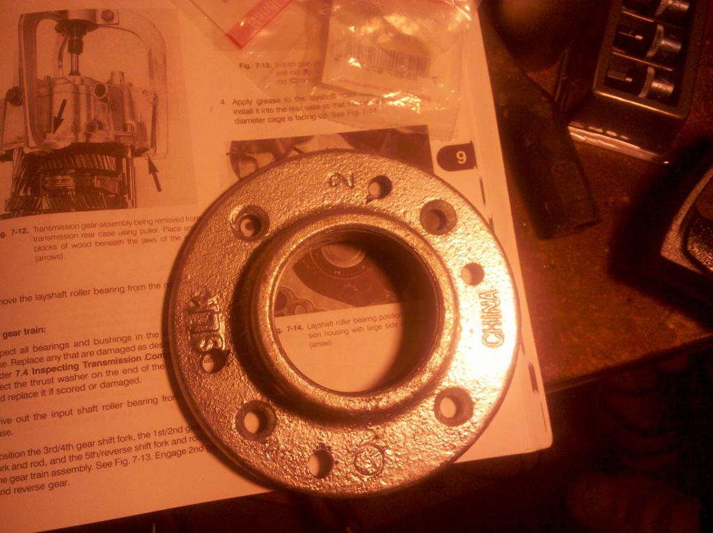

I went to the hardware store and bought the below items:
1) Pipe Flange
2) 6 inch long 2 inch diameter pipe
3) 2 inch to 1 inch reducer
4) 6 30mm #6x1mm flange bolts
(all together these parts cost ~$22)

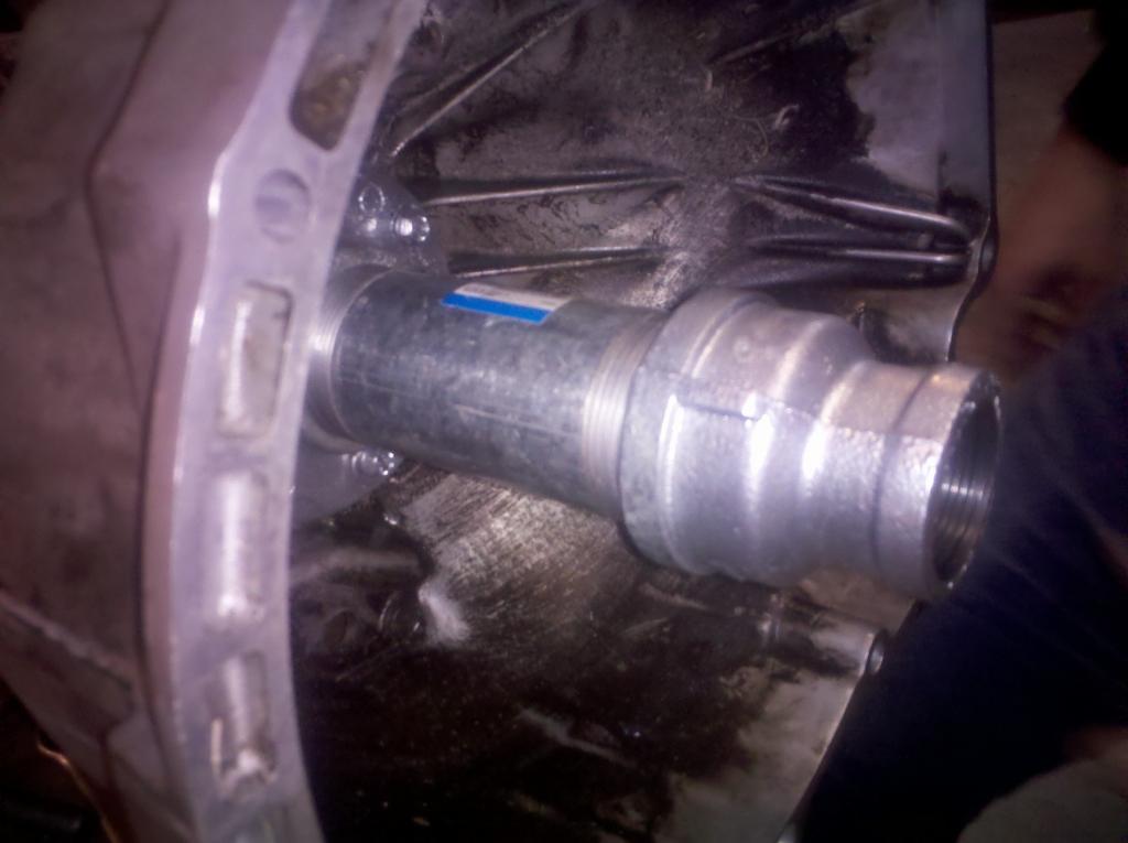

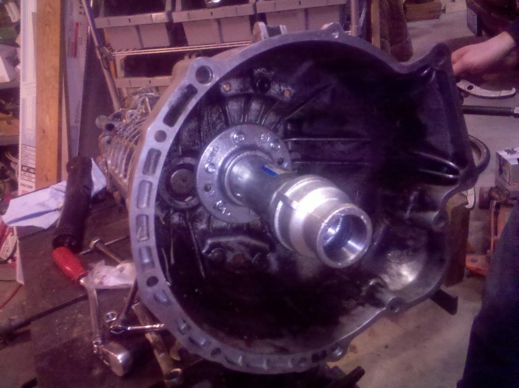

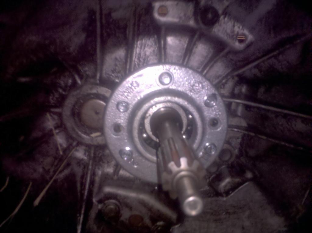

I then drilled holes in the flange to match the transmission housing.
I then bolted the flange to the transmission housing with bolts mentioned above.
Next I mated the piping with the flange, and then put on the reducer.
I then used a pulley puller (everyone should have one of these...they are worth buying) and pulled on the outsides of the reducer adapter. You can see it here on youtube:
