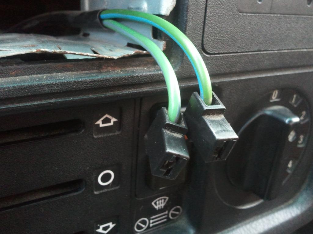

                            Hi, according to the last post, i capture some photos to see you exactly the wiring connection.
                            On the first attached photo, yo can see 2 gray-green wires. These 2 wires are connected on the window breaker switch.

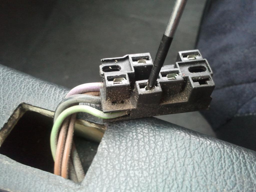

                            The second photo shows the wiring behind the driver's window control switch. I checked the circuit between the left wire of the first photo and the #3 pin (to the point the screwdriver points) on the driver's side. I hear the "beeeep", so there is no wring cut.

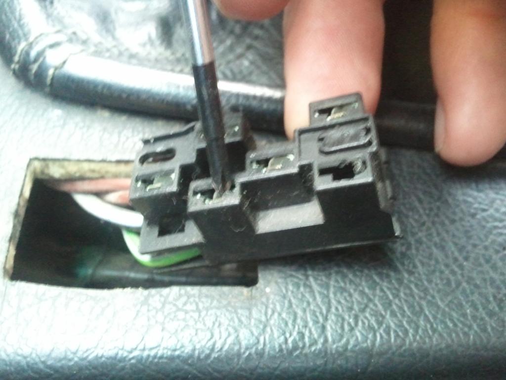

                            The third photo shows the wiring behind the passenger's window control switch. I checked the circuit between the left wire of the first photo and the #3 pin (to the point the screwdriver points) on the passenger's side. I hear the "beeeep", so there is no wring cut.
                            In addition, there is a circuit between the #3 pin at the driver's side and the #3 pin at the passenger's side.
                            What is the spare gray-green wire (the right one) used for? My windows are free to be used, even though the window breaker switch is pressed or not.
                            Thank you in advance.
