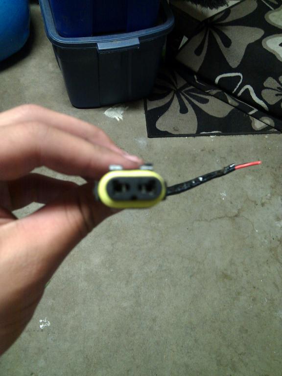

As you can see, this is the back view..So as I could, I went to realoem.com to search for the correct plug to make my harness, I found it but after calling all dealerships in my area they did not make the terminals and they suggested to go to a junk yard and cut the plugs, so after calling up some yards and visiting some, I found no plugs usable :( after having my lights sit as decoration for some time, and my brothers civic's engine blowing up, I took the HID's out before the tow truck could take it and took a good look at the plugs
and from looking at the pictures, I thought I could make this work !

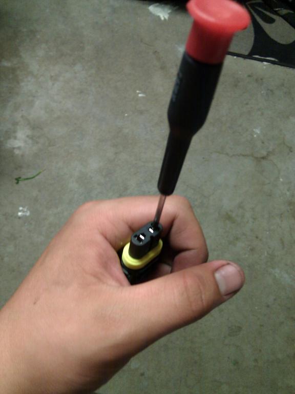

so what I did was grab a small Phillips head screw driver and jam it into the terminals so they can accept the rounded terminals in the fogs themselves

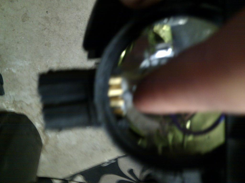

Ok, now were getting somewhere. But BEFORE you plug these into the lights you will need to open the light and hold the backside of the terminals so the plug can fit on and not just push the terminals inside the light housing
from here you can push the terminal in and I would suggest putting some silicone around the plug so it will hold a seal in the housing. Ok the big part is done, now all you have to do is find the early model fog plugs

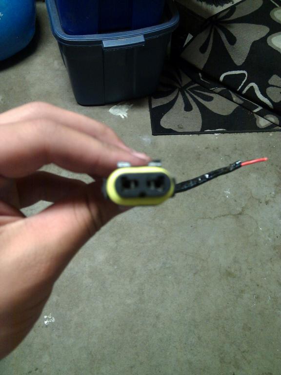

which look like this, cut the wires, sell them on ebay and wire the new plugs for your lights in ! and done !
