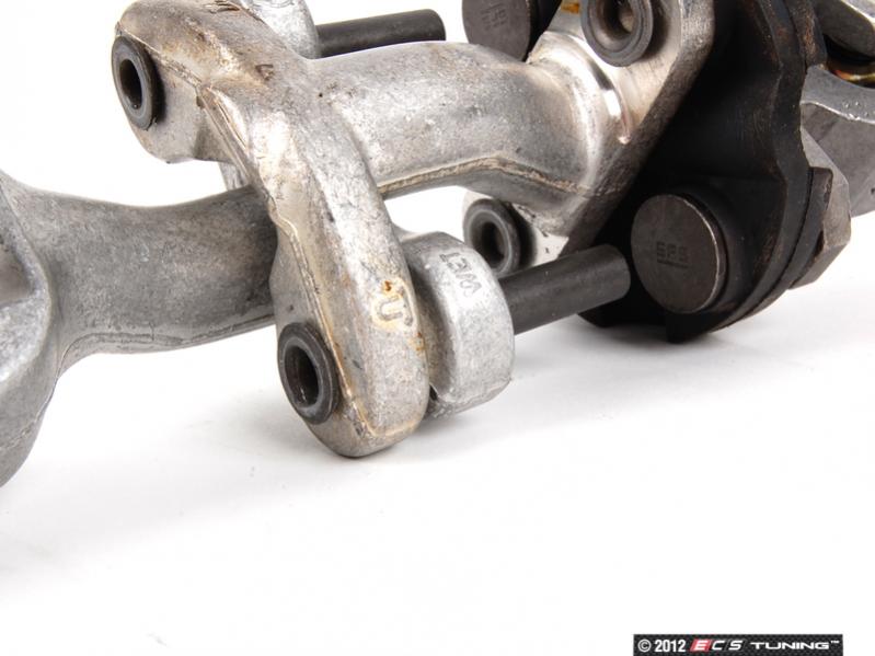

I have a serious question about the collapsibility that was designed in to the stock steering linkage. I've posted some questions before in the steering section about our odd-looking hardware, which I've found was because of an earlier recall for safety. As the linkage shears off the rivets in a front end crash, these steel plates keep the ends of the shaft aligned so you still have some steering.
The newer (replacement?) linkage has those long studs on it, which I assume does the same thing - the pieces slide down those studs, but are still aligned so you can steer.
A guy WAY back in this thread mentioned trying to use plastic nuts or some solution on the linkage spacers so they'd shear off in an accident. I don't know the result of his experiment.
All the aftermarket linkage kits are pretty clear that they're "track only" pieces for liability reasons, and say you should be wearing a harness so you don't hit the wheel. For a street-only car, that doesn't seem like a decent solution. My kids will be driving this car.
In post # 865, a guy mentions it:
2) Safety Loss--The mod that everyone does takes away the column collapse safety feature. I am interested in the method shown in post #856. I didn't do this one, but wonder if it would be the safer route. Watch the column come at the dummies head in this video on the old chevy at 49 seconds. Sorry to be a Buzz Killington, but it is worth mentioning.
These guys have a telescoping center sleeve, but they say the same - track only.
chrisnxl185's solution of taking out the giubo and bolting the two halves together with a heavy washer leaves the shear hardware intact, but is a more rigid connection. Others have said that rubber giubo is just for noise isolation and not to worry about it.
I'd like to use the Dungeon spacer kit.
The later cars had a solid shaft with no collapsing hardware, but of course they have an airbag to break your fall.
So..any other ideas on leaving this safety feature intact while shortening the steering shaft?Comment
