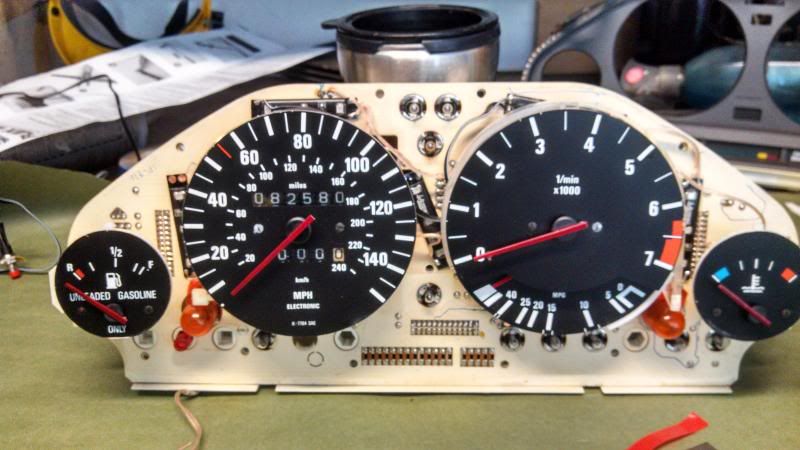

    1. First remove the cluster and disassemble. You do not have to remove the clear cover. I had to re-glue mine.
    2. Remove the LED strip and prepare to cut it into pieces. There are specific places that you need to cut it. The package comes in 2 12" pieces.
    3. You need to cut it in specific places. You must be between the copper circles so you can attach the wires to link then together. I tried to experiment with them and i can tell you 100% that you must keep the entire section with all 3 LED's together to get them to work. If you do not need to link the rear of the set, than you can cut it just passed the last diode.
    4.This is what you need to get it to look like to solder the wires to the strip.

    6.Lay out the LED where you would like them. You must pay attention to screw holes and bulb surrounds. You will be really sorry if you mess that up.
    Things to keep in mind regarding this step. You must pay attention and make sure the polarity is right. LED's only operate with one direction of flow. If you get it backwards, no big deal just switch the wires. No harm done. Also the electricity must flow in the direction of the words. It will not run backwards Take your time and get the wire cut to the exact length you want it. there is not a lot of room in there.
    7. This is what i made for the circuit board. 7 LED sets wired in series. I suggest checking your work as you go. i used an external 12v power source, but i think you can use any battery from 9v rectangle battery to a cordless drill battery.
    8. Here is where I placed them. 2 are hidden in the pic. They are on the bottom edge of the speedo and tach.

    I scraped the paint off my needles because i didnt like it at night. the following pic is at full blast dimmer, the latter is turned down all the way.
    So in hindsight, I would do the 4 in the front, but tint them with spray tint. Painted needles sucks. LED's are the Shit. Obviously, i hold no responsibility of how you melt your car or catch it on fire. I performed this on a 87 325es
