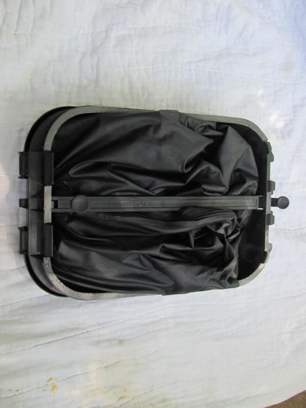

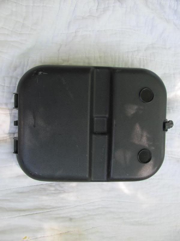

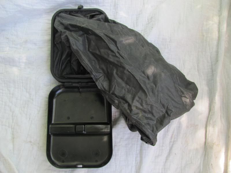

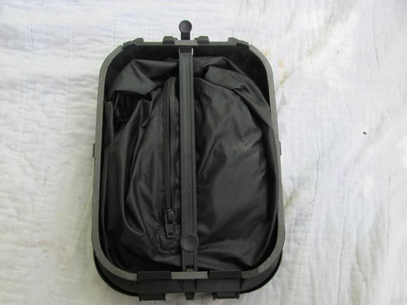

    5. Install ski pass/bag from trunk side. Clip into place along bottom then click top in place. It helps to push the top part in from the trunk side.
    IMG_1625 by itsonlygeorge, on Flickr
    IMG_1626 by itsonlygeorge, on Flickr
    IMG_1630 by itsonlygeorge, on Flickr
