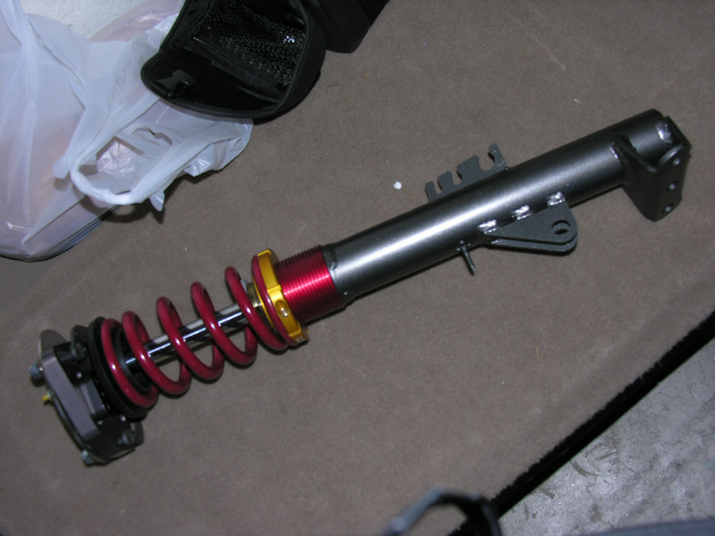

Depends on which GC set-up you go with .
You can get a complete housing wiht the adjusters already mounted and installed .
Then you can get the coil-over kit and shorten your housings and then youmust purchase inserts for a different non-e30 application .
A lower spacer and or custom revalving of the inserts may be needed .
Or you can get the coil-over kit and just grind off your lower perches and you are pretty much set .
