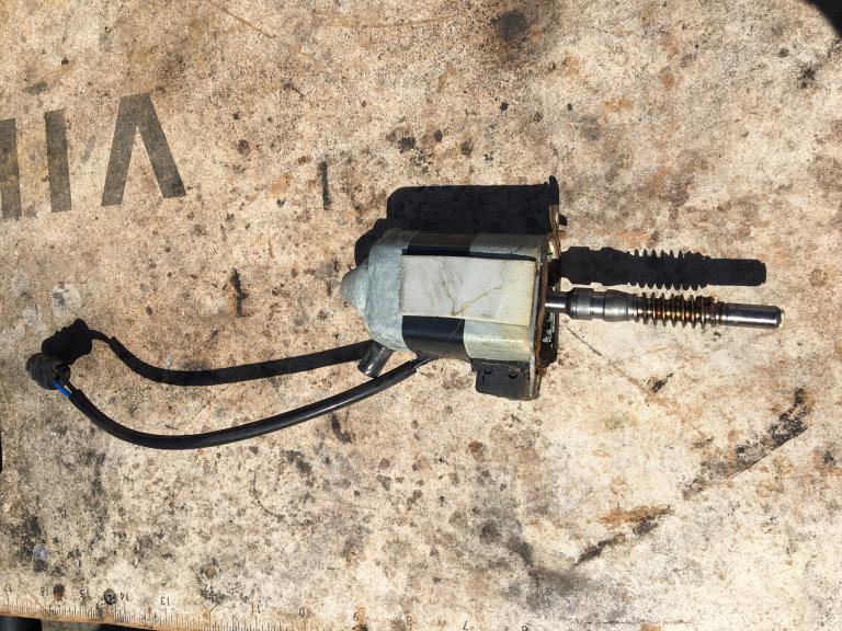

Here's the motor:

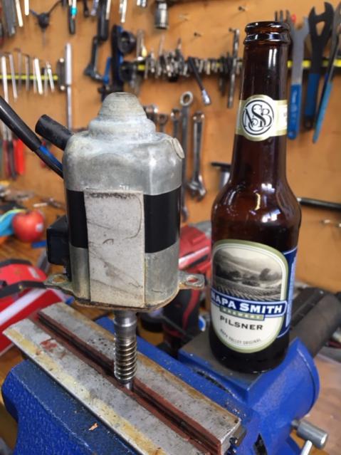

It was so badly seized that I couldn't turn it by hand. I put in in a vise, and spun the housing by hand to free it (having a beer close at hand seemed to help with the process).

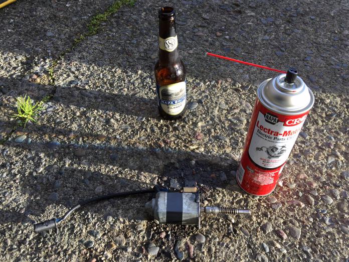

I was unable to separate the motor body from the housing, as I had seen in a YouTube video. So I sprayed electrical parts cleaner into the motor while spinning it by hand, tapping the bottom of the motor to free up trapped gunk, and draining dirty fluid (rinse and repeat).

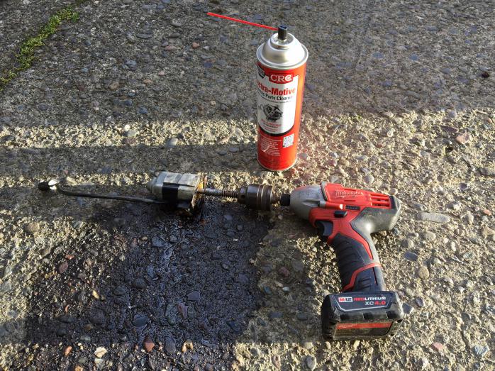

It was still not as smooth as I would have liked, so I found a way to automate the process:

Here's the motor:
