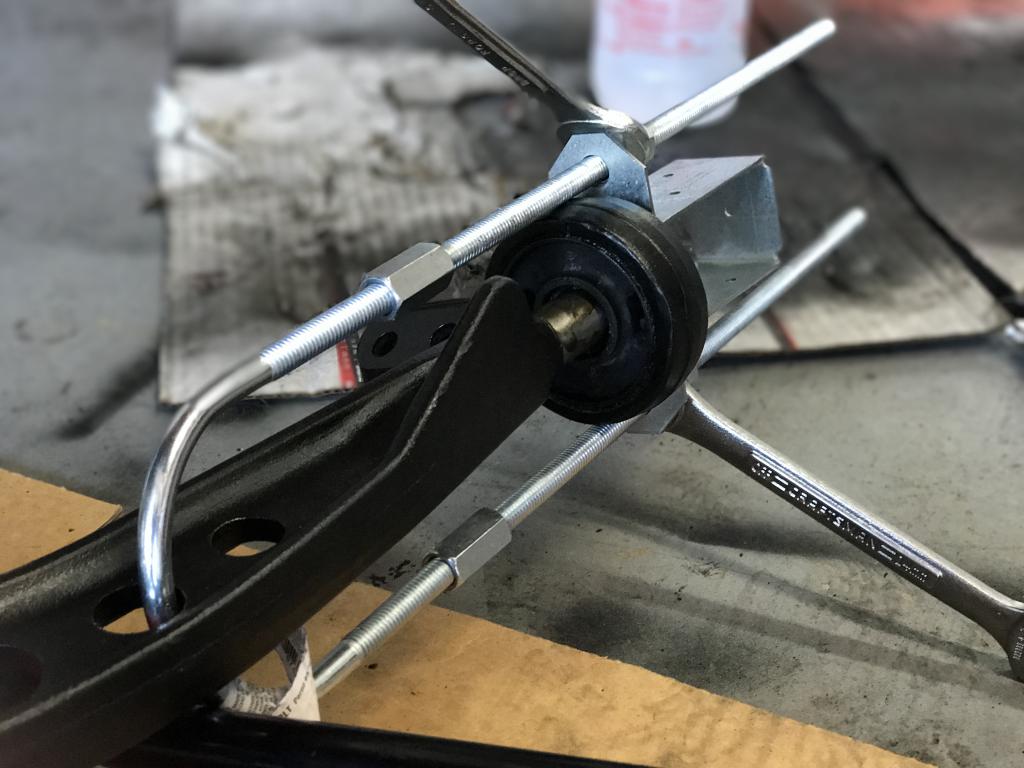

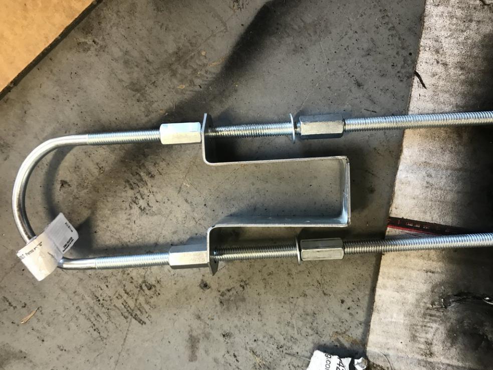

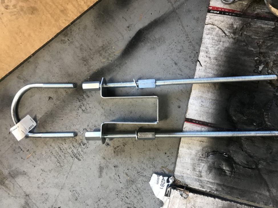

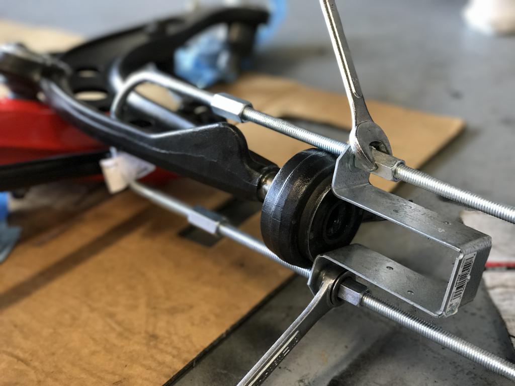

    I am currently working on refreshing the suspension and upgrading the steering rack to a Z3 rack on my E30. It was difficult for me to remove and install new bushings. Looked around the internet for help but only found a little and some old threads. So I decided to create a new thread (2017) to show with some clear pictures how to make a quick and cheap tool to install and remove bushings.
    All parts were bought at home depot. See receipt for all items needed(only the ones with blue dot next to it)
    I hope this helps someone.
