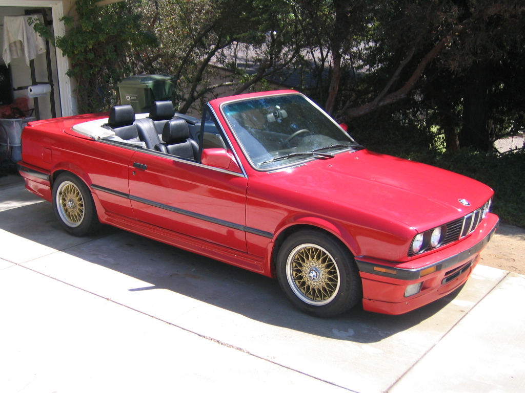

                  so easy to upgrade the iC. here's my humble 2/87 325iC

                    Yup, simplest thing to do.
                    You'll need front and rear plastic bumper with clips and shocks, front late valence, front lip (IS preferred ;-) and some kind of rear apron to stick under your rear plastic bumper if you want it to look real good.
                    Keep in mind that all the little stuff such as brake ducts, fogs or fog deletes, oil cooler trim can be bought from the dealer for real cheap (I paid something like $50 for ducts, fog deletes and the oil cooler trim all together)
