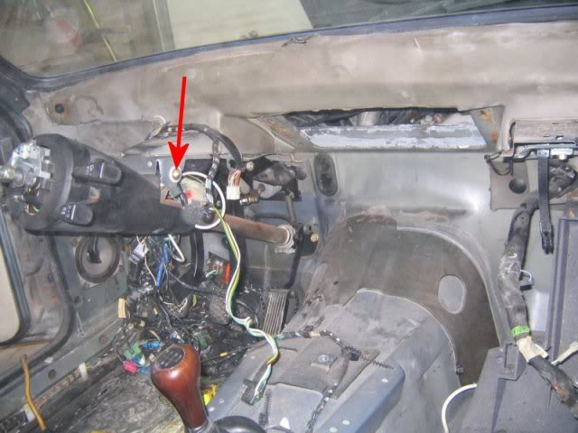

Hey Guys, I finally yanked the rug out of my car and was able to see where the water is coming from, the seal around the heater core pipes shrinks as previously posted. At night you shine a flashlight inside the car and you see it come through. So I squeezed as much silicone caulk as I could into the area from both inside and outside. Two days later it rained and still got water. Bought the expanding foam and tried to squeeze some from the inside and I come home today to find that yes I still have water coming in. I was just looking at the silicone mess I have created and the foam gunk mushroom inside my car. I guess I'm going to have to rip all that out and start again. I'm attaching this picture that I found useful not mine and don't pay attention to the red arrow, the oval rubber gasket is what shrinks.
