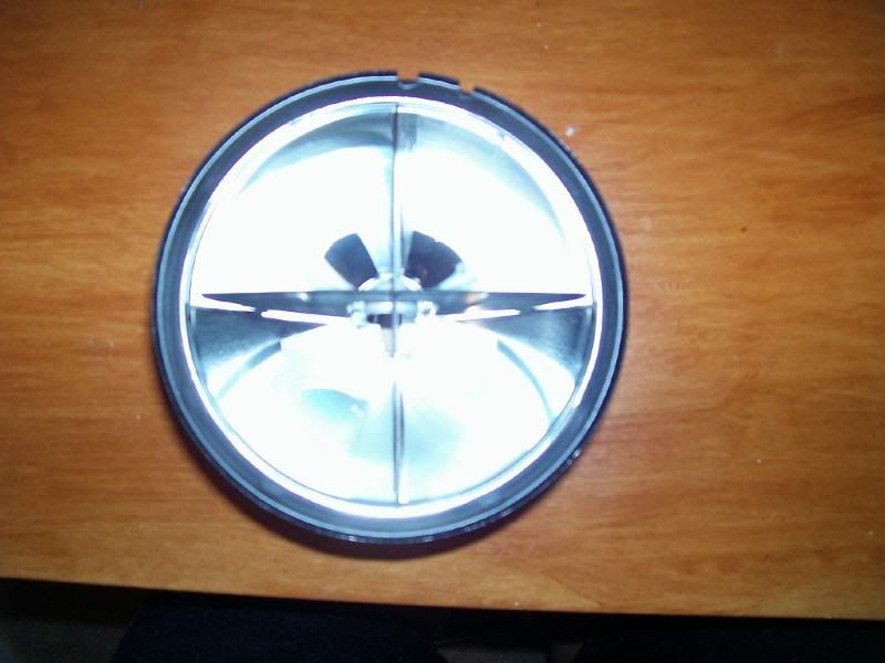

when setting your crosshairs for the high beams, use the vertical indentations on the glass as your reference. DONT eyeball them or you'll end up with crooked ass crosshairs that will look like ass when mounted on your car.Renting my rear wheel bearing tool kit. SIR

Originally posted by dillsnick View PostDoes anyone have pics with Hella Smilies smoked this way?
notice for the crosshairs to appear straight, you have to align them to the vertical lines on the lens.
I did not know this so I had to "adjust them" after I put the lens on. so you see the horizontal crosshair is not quite perpendicular.
so they should be set at approximately this position. Then double/ triple check with the lens on.
