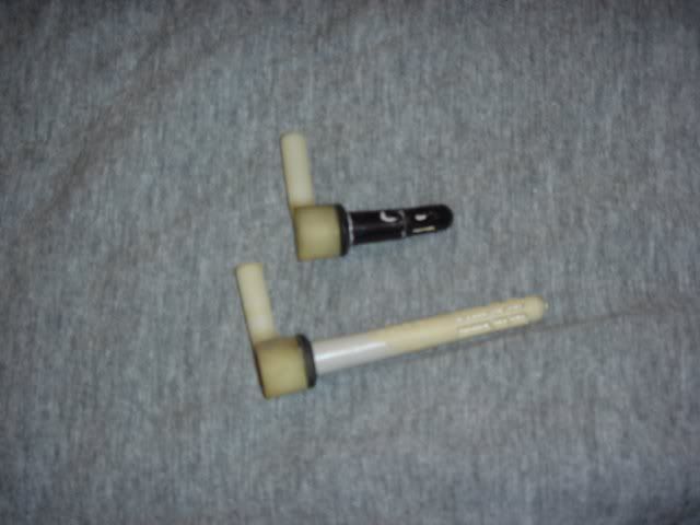

I just modded the vent, shortened it and painted it black so it didn't interfer with crosshairs.
it's much shorter, but better then nothing. no problems yet, it's only been a week however.
