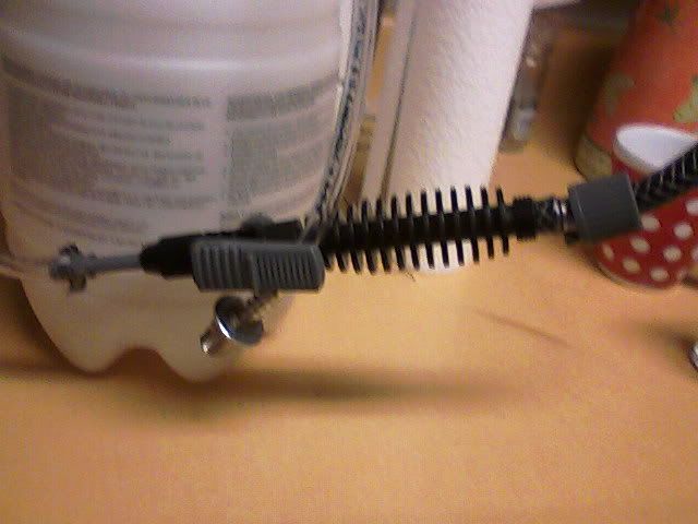

                  just built one today to use on my '02. i have not gotten a cap yet and will try and find one that fits on my 'o2 tomorrow. ill post a picture of the finished product.

                        here we go. sorry for the bad cell phone pics. my mom took my camera to india for a month.
                        so i kept the spray nozzle thing on it so that i could start and stop the flow of fluid when ever i wanted. i could not find a bolt on valve stem so i just got one of the push in ones and epoxyed the shit out of it. turned out great and has no leaks at all.
