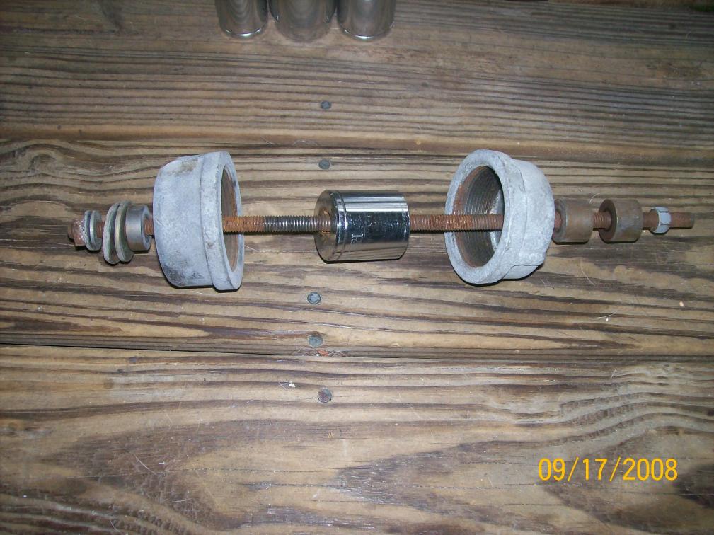

    Rear wheel bearing tool for about 20 bucks
    This is my home made rear wheel bearing tool that I made from parts you can get at lowes or home depot , someone asked me to post it up so here it is . it is 3/8 threaded rod aprox. 18 inches long , (2) 2 inch galvanized pipe caps , and asorted 3/8 washers in diferent thicknesses and sizes , (2) 3/8 nuts ,and a 30 mm socket.
    It has been about 8 years since I used it last , so I can't recall exactly how I used it , but it should be self explanatory once you are ready to press the bearing out , use the socket to press the bearing into one of the caps , it should fit , I know it isn't too pretty but it saves you some money for a tool you may use once or twice. good luck.

            jesus, don't hammer in your bearings, just rent the press from shucks, its $20 a rental and it comes with all the sleeves, presses and the huge "bolt" you will need to pull/push the bearing in or out.

                  Umm yeah, everyone has to use a slide hammer to get the hub out.
                  I don't know how that home made tool works without a sleeve for the bearing to be brought into.
                  That thing looks like it would just tighten onto the bearing and do nothing. idk.

                      Originally posted by TS87325IS
                      "This is the press , you use the socket , which fits in the hole on the trailing arm , and put the cap with the cup facing the bearing so it will press into the cap , nuts and washers on both sides and start turning the nuts , and it presses it out , to press it in , you put the bearing in the freezer for a bit to shrink it up , then put one cap on the back side of the trailing arm hole , slide the bearing on to the rod , then the socket , then the other cap , then a washer or two , and a nut , start turning the nuts and it will press it in"
                      quoted from the other thread in the subframe sub-forum

                              I had a mother of a tool made by a machine shop for $50. 1'' ready rod in the centre. My wheel bearing was a waffleswaffleswaffleswaffles though should have heard the snap when it finally let go, if it was that 3/8 ready rod in the OP's pic it would have snapped way before the bearing moved.
