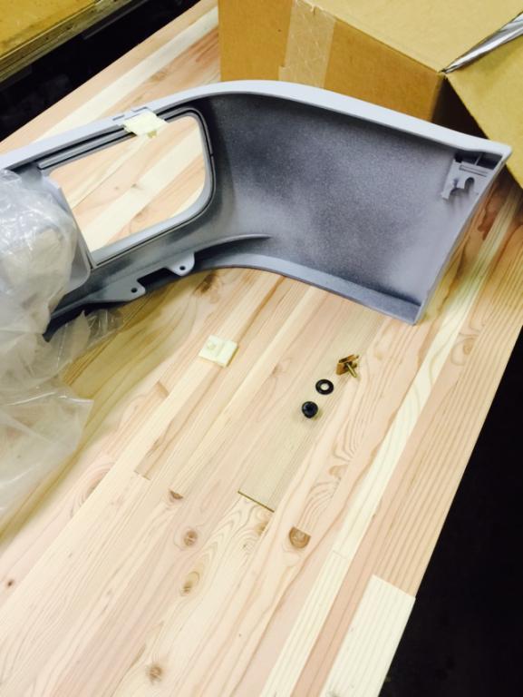

      Hey fellas, resurrecting this thread..
      Can anybody shed some info how to correctly secure front lower valance on the sides? I believe there suppose to be some angle brackets or something.
      Thx in avance.

          Post pics of the inner side of your lower valance. I might be able to help.
            Not home atm but theres nothing, only looks that something was attached/glued there..

              Let me take pics of mine and show you the hardware (I got a new uninstalled kit) needed.
              • svn2002s
                • Sep 2004
                • 486
                #37
                Pic of valance
                on the right you see items 5,6,7 from realoem.
                The white piece is item #3 (one attached to the valance and one on the table). Used to secure it to bumper (MT bumper not the regular plastic one).
                HTH and good luck
                  Pic of valance
                  HTH and good luck
                  Thx so much for pic I did reference with realoem, I'm definitely missing stuff unless euro spec valance is different, here's my valance:

                    That should be easy to fix/solve. Some ABS or Polypropylene pieces and glue.
                      I kno lol, thought I could maybe do it the "right" way, but at least I know how it should be, thx again
