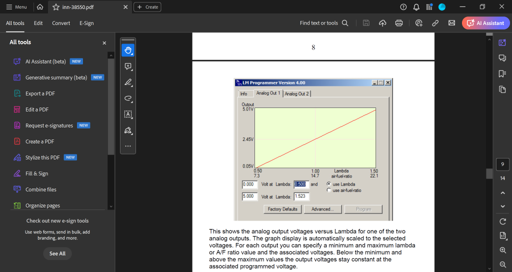

    I may be on to something. Dug into the wide band documentation and found this:
    "Optionally, the YELLOW (Analog out 1) and/or BROWN (Analog out 2) can be connected to the analog inputs of other devices such as data loggers or ECUs. If either one or both of these wires are not being used isolate and tape the wire(s) out of the way. The default analog outputs are as follows: Analog output one (yellow) is 0V = 7.35 AFR and 5V = 22.39 AFR. Analog output two (brown) is 1.1V = 14 AFR and .1V = 15 AFR."
    Click image for larger version  Name:	image.png Views:	0 Size:	152.1 KB ID:	10115533
    Gauge is an Innovate MTX-AL.​

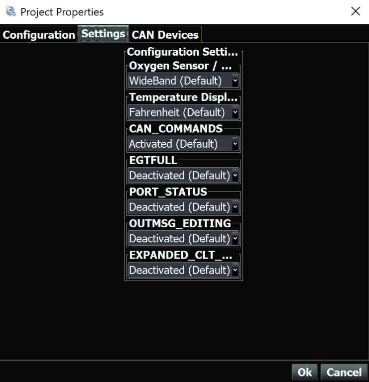

        I figured it out. File -> Vehicle Projects -> Project Properties -> Settings
        I had Narrowband instead of Wideband (default) selected. See below:
        ​ Click image for larger version  Name:	tunerstudio.png Views:	0 Size:	115.9 KB ID:	10115674
        Asterisk gone:
        Case closed. Thanks All.
