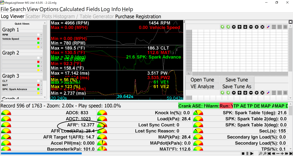

                            Hey Guys,
                            Looks like my MS2 is calculating AFR from my O2 voltage. There is an asterisk next to my AFR showing this. How do I get the log to spit out actual AFR or, for that matter, get my car to run on actual AFR ratio vs. O2 voltage?
                            See below:

                              Jake says he's never seen this before and I can't really find an answer myself. The AFR table was calibrated to the posted manufacturer's voltage. I didn't touch it afterwards. I opened a ticket with diyautotune. Will post a log and current tune tomorrow.
                              I've definitely got it running a lot better toying with VE, injector cc, injector deadtime, and reqfuel settings. Thinking I should get a 3.5 bar fpr, which is what M50 greentops need to run at the flow and deadtimes posted on the spec sheet. All fuel lines in the car have been upgraded to 50 PSI so I don't see the harm.
