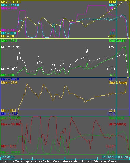

    What would Cuase big BANGS coming out of the Exhaust on ACCEL?
    OTher than That, How does The MEgasquirt Know that I have 7psi of fuel pressure at Higher RPMS. ITs an AUDI 5000 FUel pump... am I getting fuel starvtion if the Wide band 02 is still sensing still in the 11's or 12's during accell or so. I have been tuning day to day driving, but havent ventureed past 1/4 throttle, because, when it accels ill hear the BANG, out the exhaust. so I dont want to fuck anything up. wHAT DO i DO?

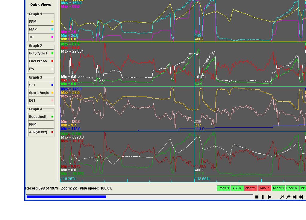

                      I dont know if the Fuel pressure and Exhaust temp are ACCURATe??? but somehow it reads it anyway. all I have is the AEM UEGO with wideband controller. maybe it has some element for temp in that??

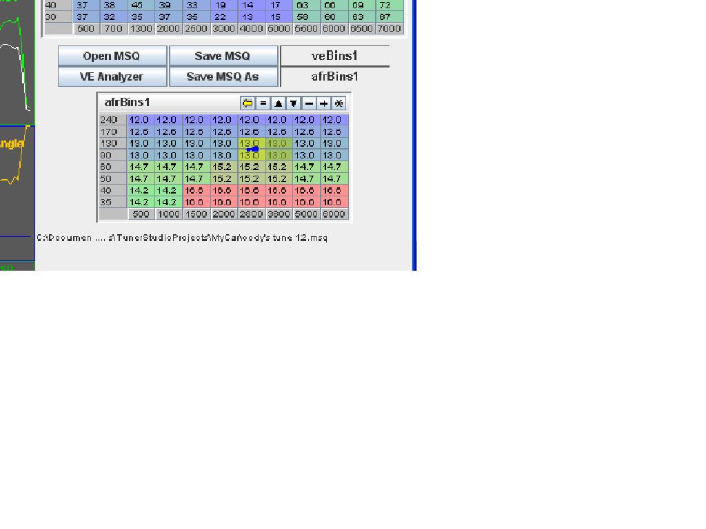

                      Otherwise. I have been using VE analyzer, my AFR targets are in the attachment.
                      Stock BMW 2002 PLugs. I forgot what They are called, ill look it up. I opened the gap A TINY MArigin though.

                        uhm did you hook up a FP sensor? because if you didn't that isn't FP.. same with EGT?

                          I havent hooked up anyuthing for fuel press or EGT. BTW I posted up the AFR table in the post above under "untitled"

                            if you haven't hooked up sensors specifically for those inputs, then whatever you're seeing in that graph doesn't mean anything. It's probably reading from one of the generic ADCs which is probably hooked up to some other sensor.
