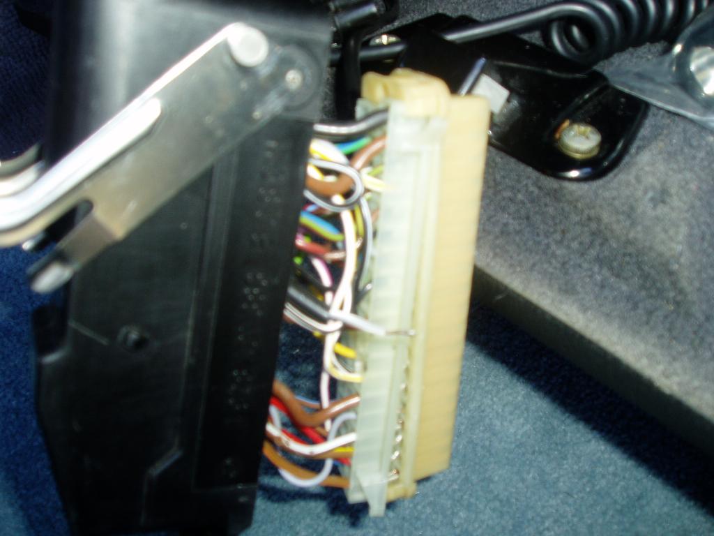

    I need the female wire connector that fits in the ecu plug from the wire harness. Anyone have an idea who supplies these.

    I'm a little confused? Are you looking for the harness side connector or the ecu side connector? I have sources for both, just gotta know for sure which exactly your looking for. If it's the harness side connector you need I have several in stock, willing to sell but please read the side note.
    Side note, the original harness side connector is a jt (junior timer) style connector. However they are no longer available. The one's still available are jpt (junior power timer) style connectors. It's a small difference, but they use different pins. There's added lock tabs on the jpt pins. You can use the oem jt pins in a jpt connector, but due to the differences the pins will never quite fit as tightly as I would like or should fit. Possibly leading to pins popping out. And you can't use jpt pins in a jt connector, as you'll never be able to get them out.
    I've built harness's professionally as a side business for years, ranging from oem style reproductions to full on mil-spec motorsport grade stuff. So feel free to ask any question's and I'll help out however I can. From parts source's to correct wiring techniques.

        I need the connector that goes on the white and grey wire on the harness side it is the female one that fits into the plug. The wire harness is a 1990 55 pin.

          Here's some pics of what I think your talking about. It's the main harness connector (55 pin).

          It may be a little hard to see, but if you look at the actual pin header (the white piece) the slots are two different shapes. This is the difference between a jt and jpt connector. The jt is a T shape, with pin locks only on the bottom. The jpt is a + shape, with pin locks on top and bottom. And as Nando thought, you can get pins from mouser. They carry either style. Hope this helps.

            White and grey wire connector
            I have attached a pic of the wire White & Grey I need the connector for, let me know if you sell this connector that will fit this 55 pin plug. If not can you give me the part number that Mouser uses.
            Thanks for your help
            Dwight
            The connector has a crimp and solder placement where the wire attaches.

              Ahh, ok now I see what your after. Went a double checked against one of my m20 harness's to make sure, and apparently bmw used jpt crimps in that connector. Guess they really didn't want people taking them out. Not sure which gauge that one is specifically so here's the part numbers for both size crimps and gauges they cover. You can order them from mouser.
              927779-3 awg 17-20
              927777-3 awg 13-17
              I think the wire your talking about is for the afm. In which case it would be 20awg, so you'd want the first part number.

                Thanks my friend I ordered them from Mouser
