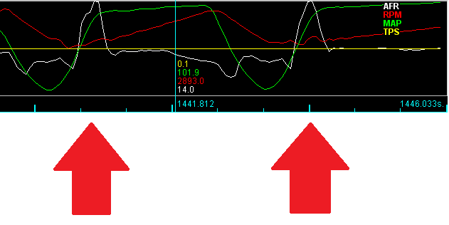

          1) Where's your throttle position sensor? MAP based accel enrichment is sub-par, I would not recommend using it.
          2) I would also turn off "EGO corr" (O2 sensor feedback) until you have a more developed tune. You don't want extra algorithms adjusting your fueling behind the scenes, especially with boost. It can cause problems by itself, and make general troubleshooting/issue isolation much more involved.
          3) I guarantee you can feel those lean spots, as indicated by the red arrows. TPS-based accel enrichment will fix this once you set it up.
          4) I would also turn off boost control until you know you can hit boost. EDIT: Definitely turn this off for now. Your boost control is enabled, but your boost duty table is zero'd out across the board.
          The problem doesn't seem to be stemming from boost. In other words I think you'd be having the same problem even if your setup was still naturally aspirated. If you know you're getting a tooth/log error, I would investigate the crank position sensor. Make sure it's OEM, not damaged, properly mounted, and has the correct electrical resistance (google it real quick but I'm pretty sure it 540 ohms +/-10). If you know it's super old or have never replaced it before, I would grab another one. Like I mentioned first, it is possible to screw up the CPS circuit if you built the board yourself. I wired mine up backwards initially because I found conflicting info on the web. The car would crank, but not run and the tooth log file looked weird. I switched the polarity of the sensor and all my problems went away.
