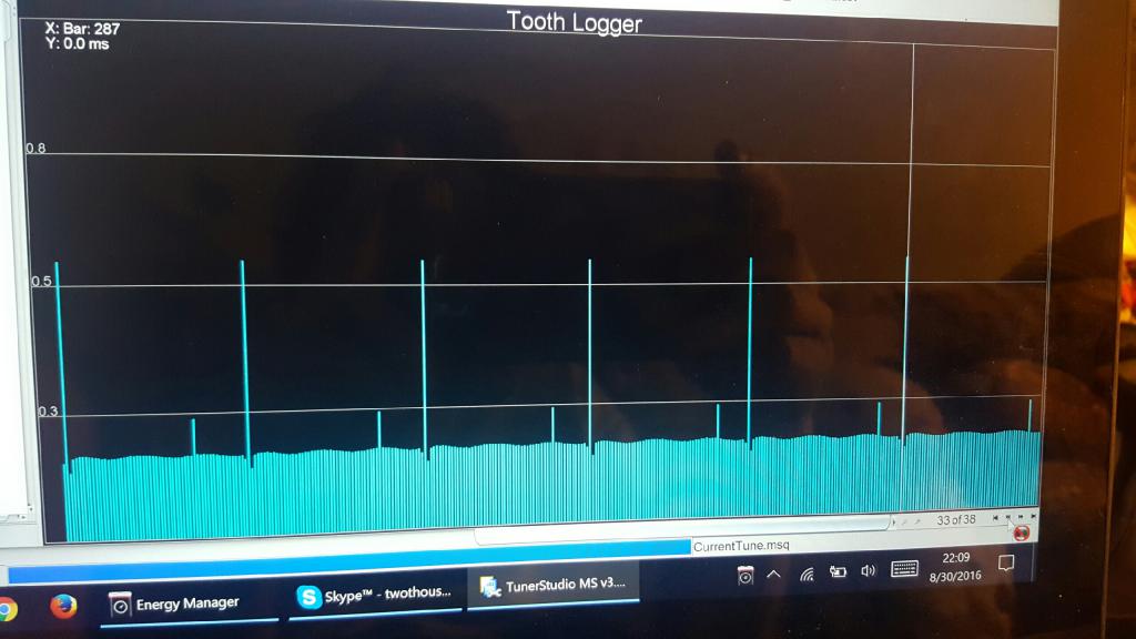

any ideas on fixing this tooth sync error?
    running whodwhos ms losing sync at 5500 rpms, tried a different vr sensor same thing, im hoping there is a way to use the noise filter to correct this
    Thanks in advance,
    Hunter

    is the sensor close enough to the toothed wheel?
    • 2002tiiguy
      • Jul 2013
      • 467
      i would have thought it was, but im not completely sure, you by chance know how far yours is from the wheel?
      • 2002tiiguy
        • Jul 2013
        • 467
        Fixed, make sure you adjust the cps gap, if you dont have a feeler gauge, a standard us dime is the maximum adjustment, if it fits between the wheel and a tooth, its too far apart

          MS seems to be notorious with this issue
