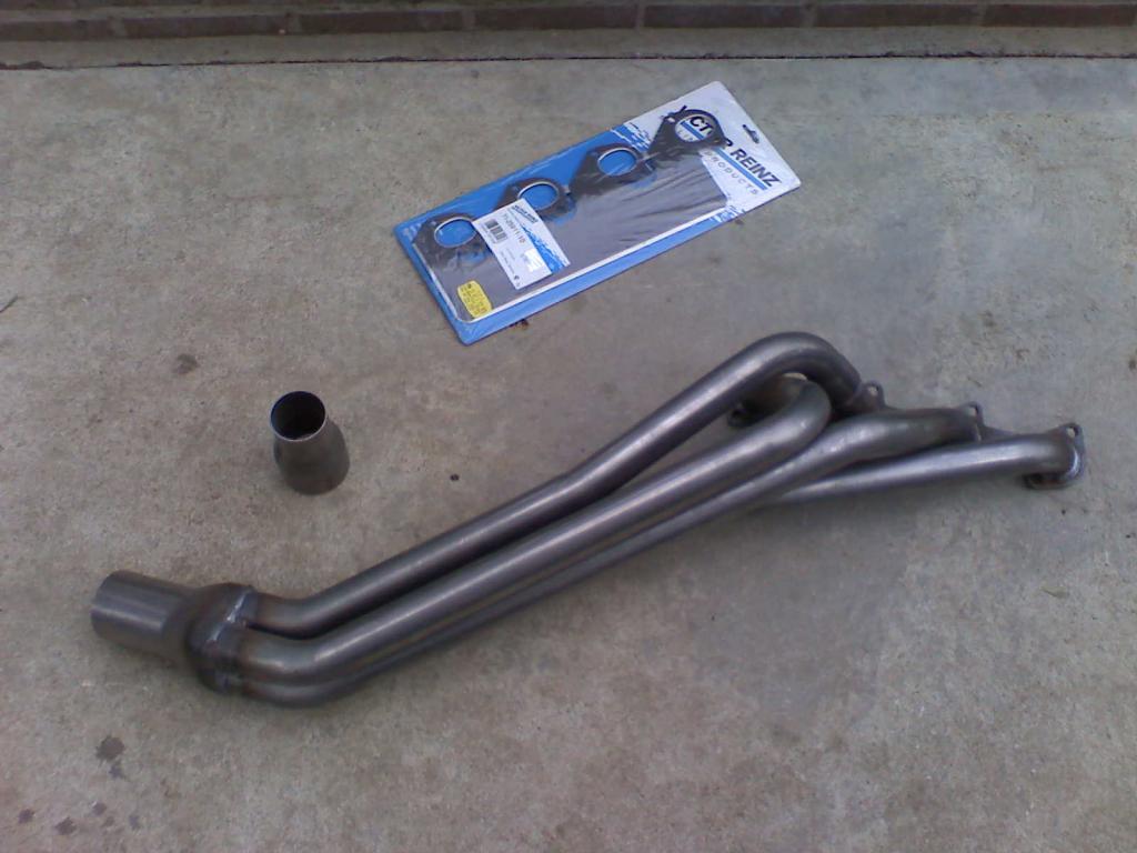

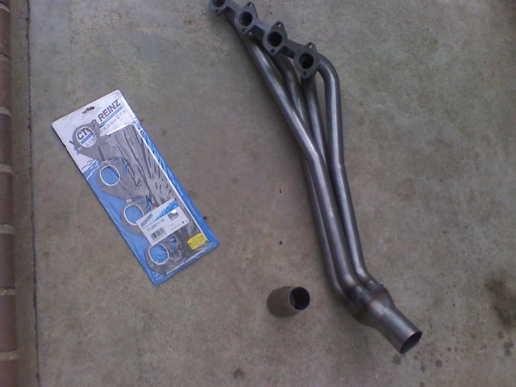

    any one every use a good high temp coating for headers?
    the spray sh#t dont work used it in the past
    i want to have them ceramic coated in the future
    but right now the fund$ aint there
    i just need something to keep them from rusting out till i can have it done right....
    got these from top end proformance
    they look hella cool
    cant wait to put them on!!!!!
