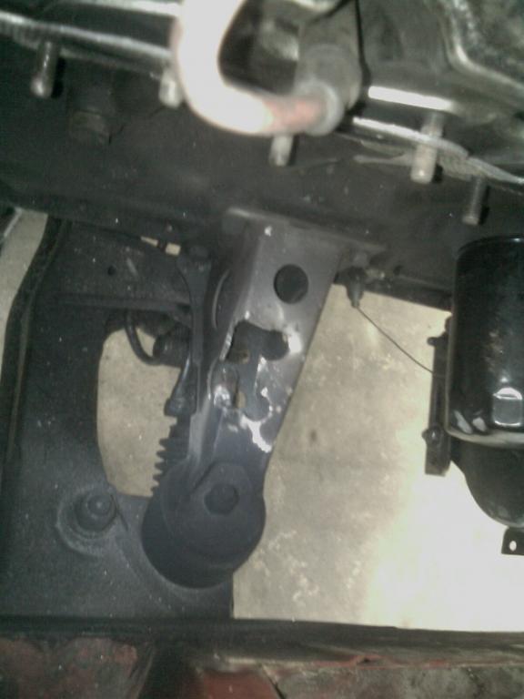

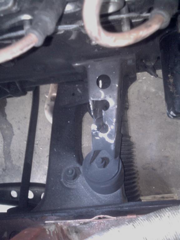

    I'd have to remove the eta exhaust manifolds (for a third time) to get the header in there and take the pics. I wouldn't mind as much but I'm trying to clean up my hands before my interview on Friday (sounds silly, but whatever). I can shoot a pic of the motor mount though and circle the area where it strikes, if that helps.

      I'd grind the mount

                    That sucks, but Headers aren't worth the effort IMO anyhow, but if you only have to cut the bracket 1/4'' cut it and box/reinforce it.

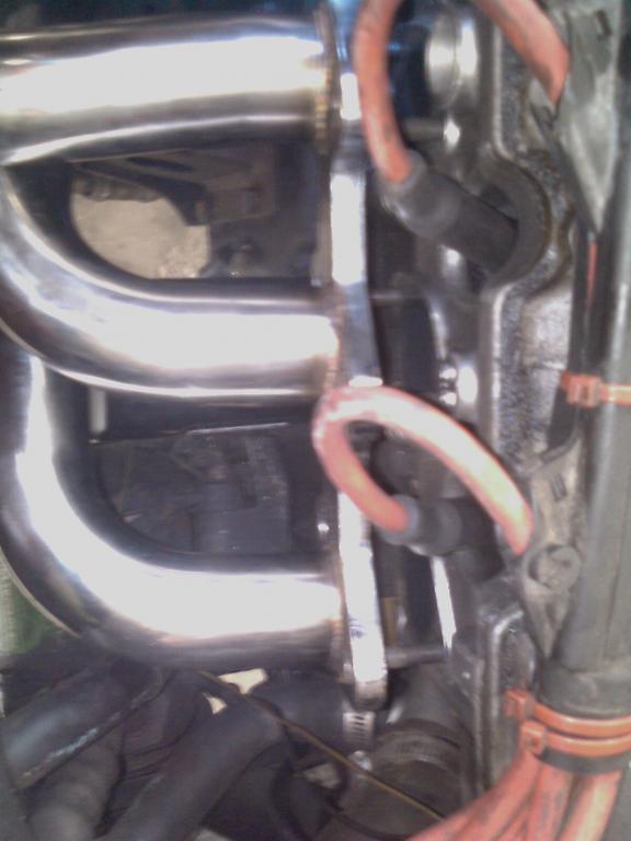

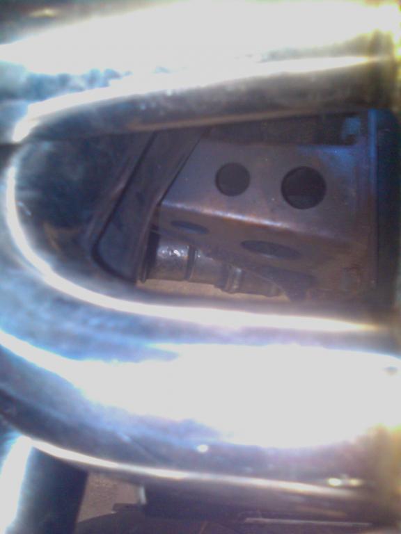

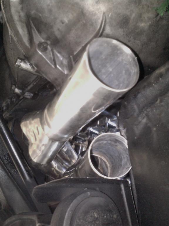

                                Here are the pics of the headers not fitting and the angle grind post mortem. Removing material from the motor mount got the headers very close, but the two studs at cylinder #1 still wouldn't fit into the header flange because the header needed to tilt downward about a couple degrees. This would have been possible if the pipe after the collector wasn't already smashed into the floorboard.
                                I ended up getting the headers to "fit" by removing the studs at cylinder 1. They still needed to tilt toward the cylinder head more (but were prevented by the floorboard), so I used the nuts to basically force the header into place.
                                On the way to the exhaust shop this morning I got a $104 for excessive noise/no muffler. Go figure. My stepdad who is a police officer told me I should be able to get it easily dismissed if I take my receipt for the exhaust work. Anyway, ended up getting the headers to truly fit by having the muffler shop cut off the pipe after the collector and welding in a new one at an angle that wouldn't interfere with the body of the car. We had already tried heating with an acetylene torch, but couldn't get it to bend - so cutting it was the only option.
