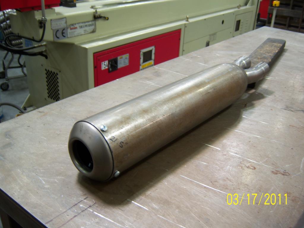

            I have custom 2-1 in mild steel 1.75" to 2". I have two vertions 1" between the two or 1.5" between the two inlet.. I can also expand the inlet to 1.875" so the 1.75" slips inside the inlet (part in picture)
            I can mod it to exit in a 3"? I'll look into it on monday..
            This is the only pic i have on hand right now but i can post up more monday...
            It's a crappy pic sorry, it's the piece at the back of the body..
