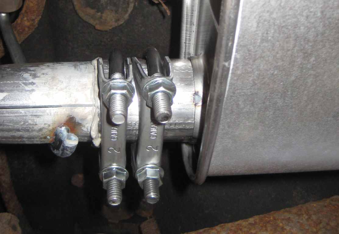

    I'm trying to install a supertrapp end cap onto my Spec E30 exhaust. Not finding installation directions anywhere...how do you do it? I can't weld it on because the whole point was to have something I could remove...
    There's a mysterious U-shaped clamp in the kit, is that what holds it on?

      I believe you slide the pipe over existing pipe, and use the U-clamp to wrap around the overlapping pipe then tighten it.

          Thanks, that was my guess, but it seems like that would be pretty flimsy. Hoping someone's done this and can confirm...
          edit: nice! What's that goop in there?
          -Sean : 91 Calypso 325i : Castro Motorsports SoCal Spec E30 #33
            Maybe some caulking to prevent exhaust leaks, but I've never seen that before either haha.
            Hi-temp material maybe?
            1991 325iS turbo
              This method has been used for many many many many many years. ;)

                Hopefully the goop is this shit
                Because those slip joints love to leak.

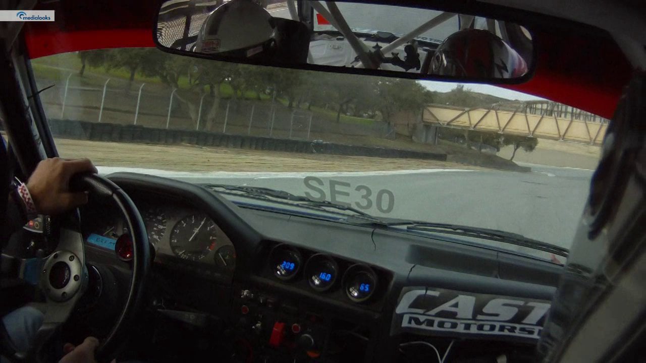

                  I mounted it, but it sticks out so far it keeps grounding out in the exit of 8 and getting ripped off. Ugh
                    video of it blowing off:
                    This is "whoops" by ignatius reily on Vimeo, the home for high quality videos and the people who love them.
