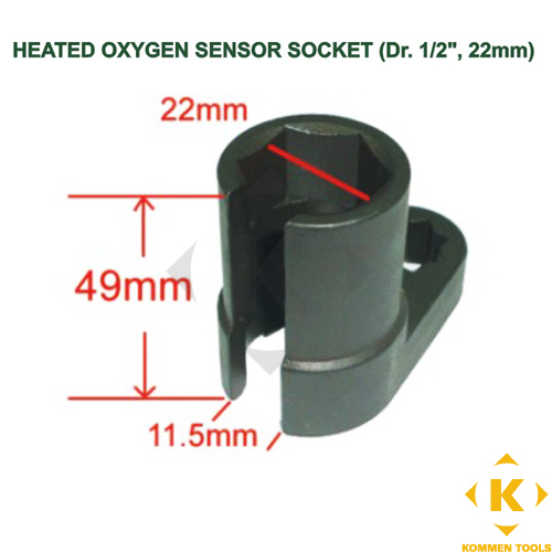

        Here I will help with an illustration 5 bucks form amazon
        Now the slot allows for the wire (otc makes one with a solid side wall but has a valley machined in the ID to clear the wire.) to remain one piece you un hook the wire slide socket over the O2 and go to town with a big breaker bar. If you have a tight spot and cant use a breaker bar then you have the 6 flats on the top to put your wrench on and turn it that way
