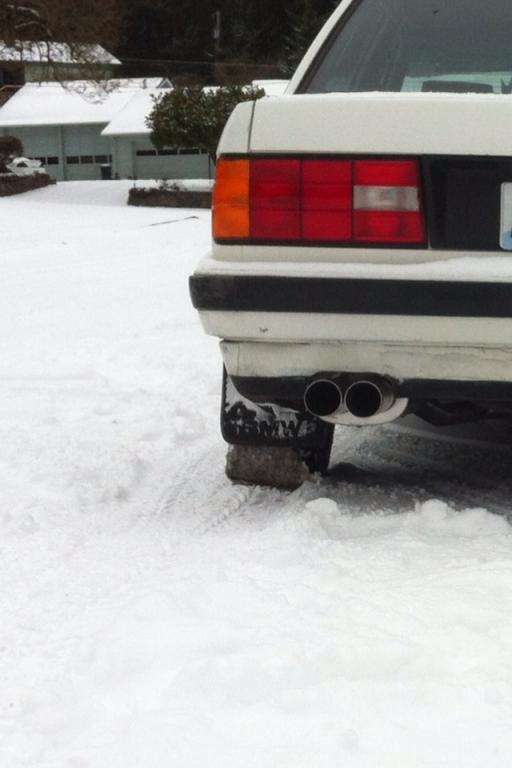

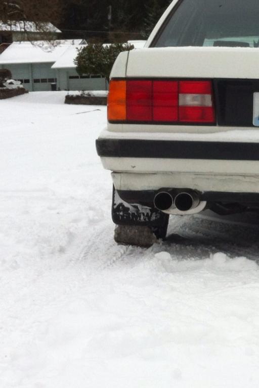

          For reference, this is mine. Magnaflow 2.5" dual tip, did have to cut valence to make it fit right. Built from the cat back with 2.5" pipe and a 9" glasspack. Sounds good and doesn't make it seem like I'm burning rice with my m42

            Originally posted by shameson
            Follow Chugs advice
            [ATTACH]83276[/ATTACH]
            So i should change out the resonator for a glasspack? How big of a glasspack? Also can i get the number on your magnaflow i want one lol
