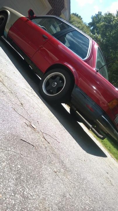

              • Sykohtic
                • Nov 2013
                • 203
                Only pic I have on hand currently
