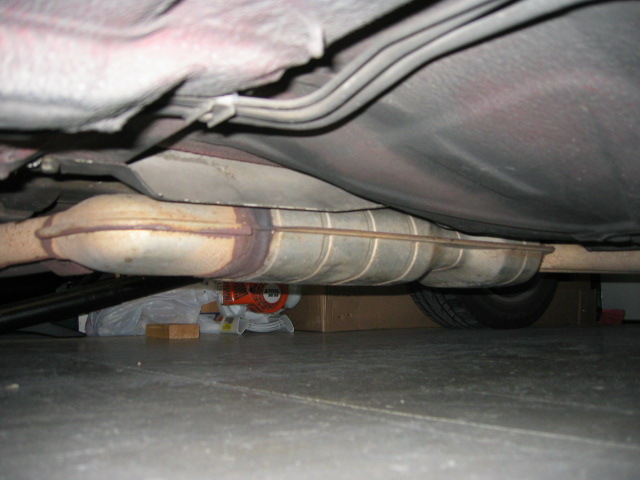

    Euro 'i' car. I was told that the car did not have a cat, but it certainly appears that it does. Opinions?

    You know, it looks like a cat, but I guess the best way to tell is to smell your exhaust. If it's not running a cat, it will probably have a nice odor to it. if not, it shouldn't be as bad. That could be a resonator of some sort, but I really don't know. :-\
    - Sean Hayes
    • tonytony
      Knee deep in poopie
      • Jan 2004
      • 3498
      looks like a cat to me, take it apart and roll a marble into it:)
      • SchnellerVert
        • Sep 2005
        • 3948
        That's a cat. Late model car? Early EU cars it was optional, late model mandatory.

          '86 Euro M20, gray market.
          The exhaust is fairly strong, but not as bad as an S14 with no cats.
          Edit: There is not an O2 Sensor on this car.

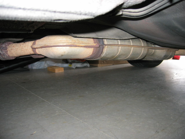

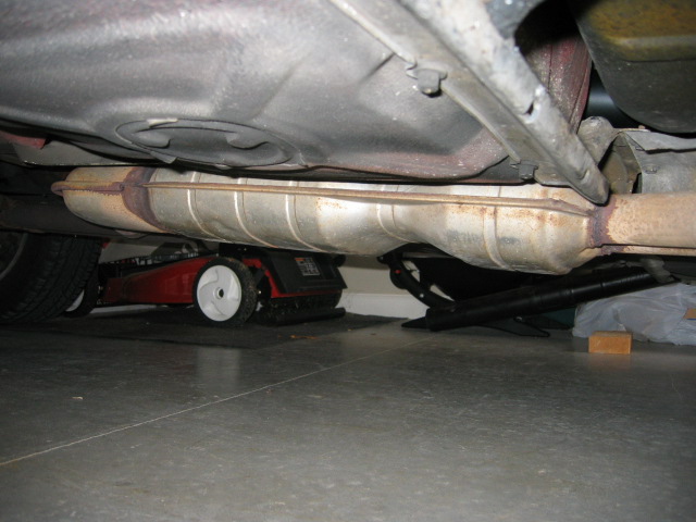

                    Snapped a few more pics

                      The only issue is now finding a proper fit exhaust due to cat backs will be to short.
                      SuperSprint sells an EU set for the 323i e30's that fit as well as BAV sells this exact system.

                        I was considering using the Eberspacher - BMW p/n 18101705783. According to ETK this is the part # for this specific car.
                        • nando
                          • 34827
                          that's definitely a cat.

                              Did you ever find out if it was actually a cat or just a resonator? I was looking at this on realoem after searching for an " '85 Euro 325i" and found this:
                              http://www.realoem.com/bmw/showparts...07&hg=18&fg=05
                              It says it is for a catless system, but looks similar to a cat. Also notice the cost; much less than an actual "cat" system. Is it fair to say that there is just a standard resonator inside there?
