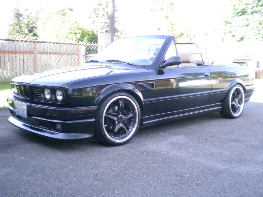

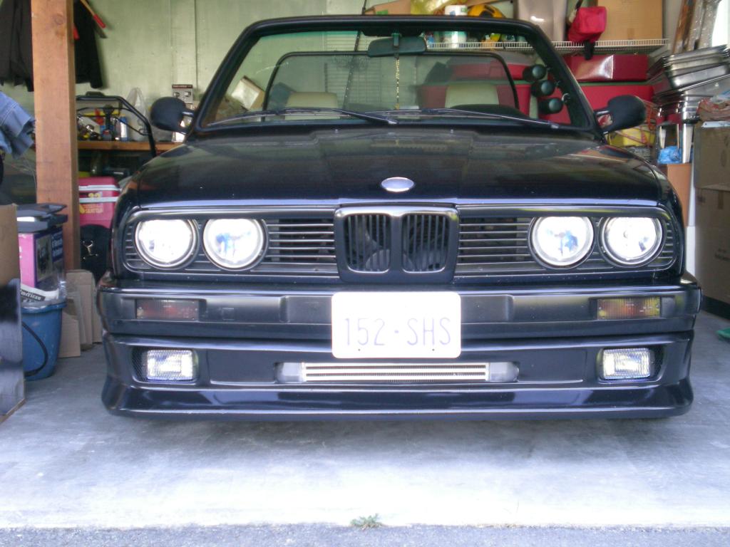

    Project is about 90% done, still having issues with the Megasquirt. Made good power on the dyno, but is having problems running on the street with MS. I have the AFM and stock ECU on it now until I figure out what to do.

          good job on the turboo. any vids? not diggin' some of the exterior parts though, but if you're happy then

              this isn't my thread..it's all you. just an opinion, i'm presuming you're open for a lil c/c.

                It's all good. I just wonder why peeps always talk shit about my car when I post something and then you see their car and it's a POS.

                    fmic, 2.5 piping

                      Well, most people are not a fan of those side grillzzzzzz. Those should only be found on e46 M3s. But whatever floats your boat. And like the guy said before, its a little bit of c/c. I dig your car, except for the grills, and those wheels. But if you like it, then rock it my brotha!

                        I like the front , side and rear valence's , what are they anyway , almost look like racing dynamics , oh and nice looking turbo setup too.

                            Holy shit nice car :o Im normally not a fan of e30 cabrios but yours is damn sexy :D
