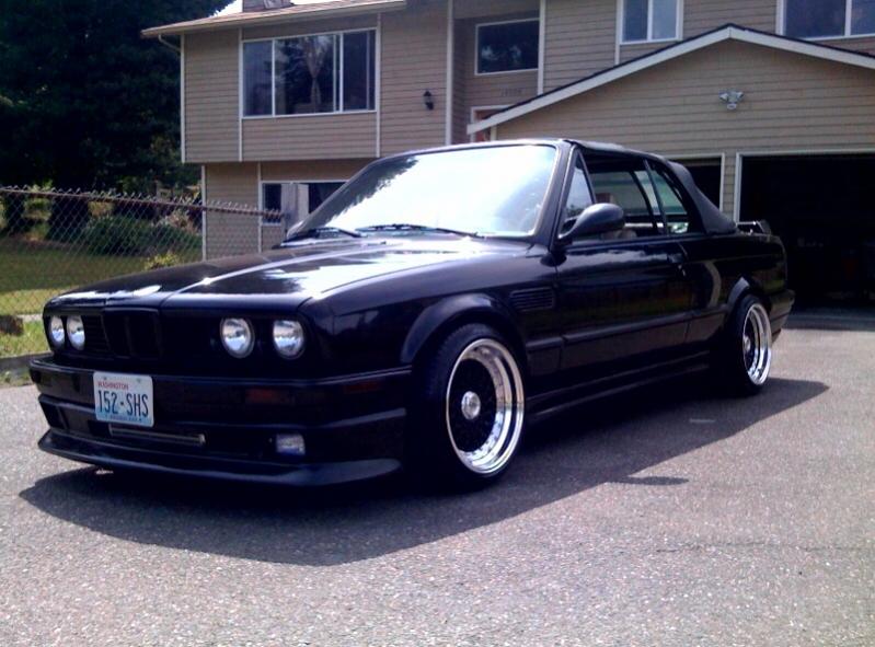

                  Update: Car is running great after installing new coil drivers. I have about 1500 miles on it now and all is good! I GPS the speed the other day and it hit 130 with no problem and was still pulling hard.
                  I put some new shoes on as well. Thanks to all who helped with advice.Click image for larger version

                    Nice wheels, Got it on a dyno yet with the MS?

                      Those rims are a hella lot better!

                        it's amazing how wheels change the look of a car. beginning of this thread i was like :weak: now i'm like :up: good job with the turbo
                          I put some new shoes on as well. Thanks to all who helped with advice.[ATTACH]22141[/ATTACH]
                          so the high dwell you were running did kill the coil drivers.
                          glad to hear it. :)

                              Your car is badass! Turbo m40/m42's FTW!
                              That's a lot of things to be! Alas, I feel the same about the wheels, the new ones look heaps better!:)

                                Do you have any idea what the kit is? the side grills are tne million times better black, but still ass if you ask me, the new wheels make up for it though ;)
                                GREAT WORK!
