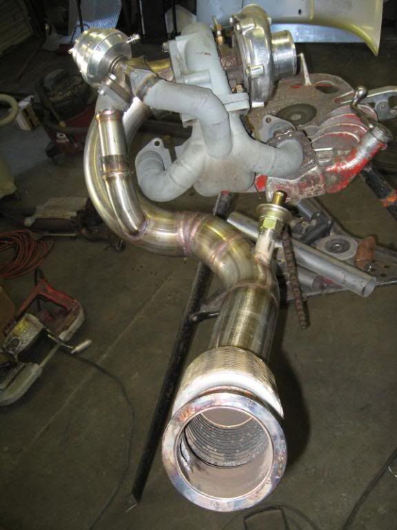

        Just do a cat test pipe and pull the cat It's what I would do. AV12 is the breather I use... just match up the pipe threads to an appropriate stainless nipple (I think it's 1/2" NPT) and put it in at a really low angle (best if in a bend at the heel). I usually weld an An fitting to it and use a braided an12 hose. There is quite a bit more that goes into it to make it work correctly so many times people do it wrong and it doesn't work.
          #34

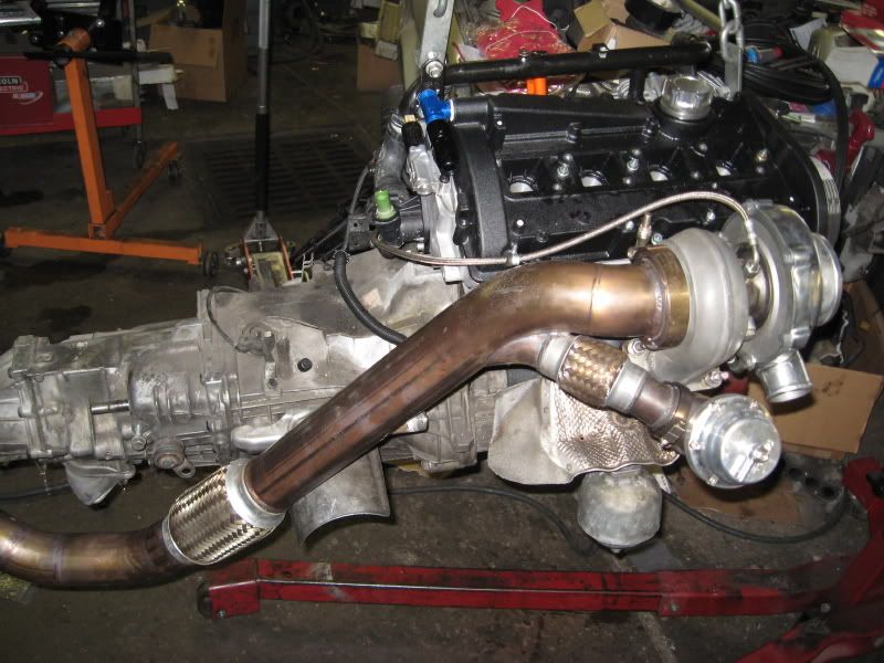

          Here is one example that is almost done (in pic almost done... car long been done)
          Here is another on an Audi A4 that I did... the valve was removed... but you can see the nipple. Both work really well on their respective cars.
