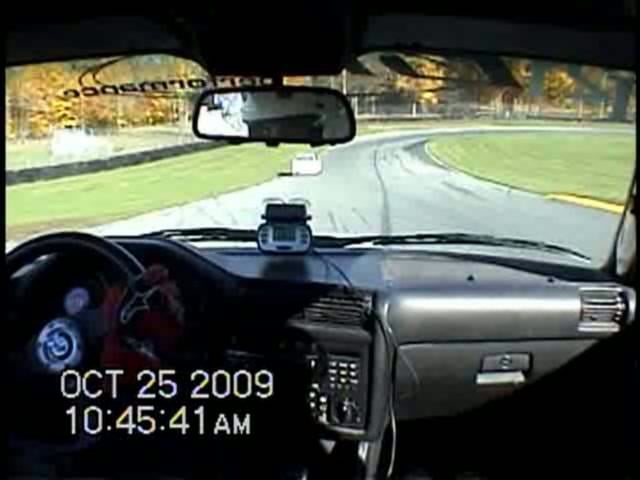

    Some incar video of the worst suspension setup we tried that weekend
    The first track test of the DTR / Street Survival One Lap of America car. This was the car's first time on track after a lengthy and thorough build by Kevin…
