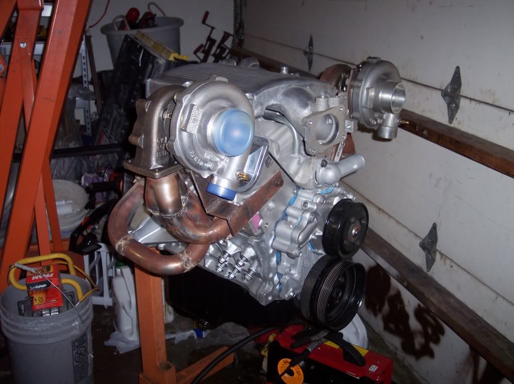

              Can we see pics of your firebird?
                I just took it out of my sig :p
                Current build...
                Old setup...
                john@m20guru.com
                Links:
                • ForcedFirebird
                  • Feb 2007
                  • 8300
                  Still have a lot to do to get the new motor in. 1000hp Aeromotive fuel pump, 1/2" fuel lines, one WG isn't welded to the header (headers getting ceramic coating in my new coating rig), down pipes, 3 BAR MAP, pin swap to use the modified Syclone/Typhoon code mask on the OBD1, and still need to buy/install the W2A I/C with cold side.
                  Already installed a nice rear (7.625" Borg Werner 3.45 w/disk), 3" exhaust, guages from the 1st turbo are there, WB there etc...Also have 11" draglies, and am going to be doing some supension work to get it to launch a little better (best of a 2.1 60' :()

                    That's a crazy single turbo setup.
                      Yeah. That's the simple way to turbo the f-body, go under the frame where the a-arm meets it. Lost about .25-.5" of clearance that way though haha.
                      The new air to water i/c will sit where the old turbo was. I dropped the power steering in favor of a turbo and manual steering box on that side so I could keep A/C (get's hot here in Fl).

                      • Farbin Kaiber
                        Lil' Puppet
                        • 29502
                        I see faulty cylinderheads. Looks like the machinist inadvertently filled and machined the #6 exhaust port.
                          HUH? I am the machinist;) Fact, I'm working in my CNC shop as I'm playing on the netz...

                          • Farbin Kaiber
                            Lil' Puppet
                            • 29502
                            SBC joke. I forgot to add required smilie. Should have claimed there seems to be two cylinders missing I guess.
