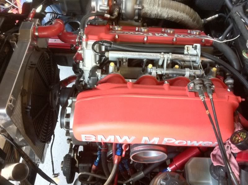

I think we may get ignition this week! I'm optimistic... (Damn MegaSquirt... soon to be for sale...)Rich!Comment

When S14.net finishes their server update I'll post the build thread but I built the motor in '08, drove it for @two years sans turbo doing a proper break-in and mapping on MegaSquirt 2 before installing the turbo. First goal is to get the car finished and out of the shop with the new Megasquirt 3 ready for active duty! From memory...
Engine specs:
94.95mm JE Pistons lightened / gram balanced / hard anodized & ceramic domes
84mm OEM crank lightened & dynamic balanced with EVO flywheel, P.P & clutch assembly
-Pauter I-beam rods w/oiling provisions
-ARP 2000 bolts / studs throughout (ARP is garbage... switching to Raceware)
-Race Ported BVHead... Disclosure: I'm bound not to disclose specs & pics, long story, but I'll be altering it (inconel valves, hard anodize intake ceramic exhaust & chambers) so it won't be proprietary property. SMH
0.98" Cometic MLS HG (8.8:1 CR)
Denso Iridium Plugs
COP*
J&S Knock Controller*
EVO oil pump
EVO style oilpan large sump (no a/c)
Injectors are being switched from RC Racing 750cc's to Injector Dynamics ID-1000 this week to accommodate E85 during the hot summer months without compromising power or flow.
Turbo is rated for 500hp so I'll be pushing it...My goal is reliably boosting from 15-24psi ~ 400 rwtq. without breaking... much :D
Diff. is 3.73 LSD now plans to go to a 3.46. Transmission is stock, but I have my eye on a Tremec if anything breaks.Last edited by ///schwartzman; 04-29-2012, 06:01 PM.Rich!Comment
